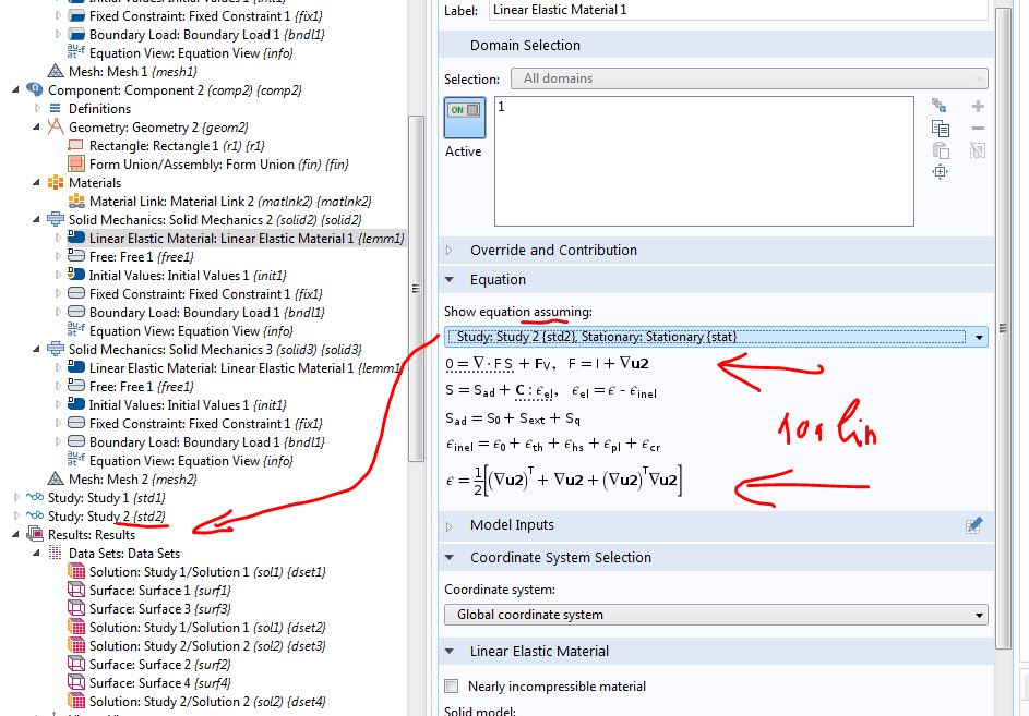

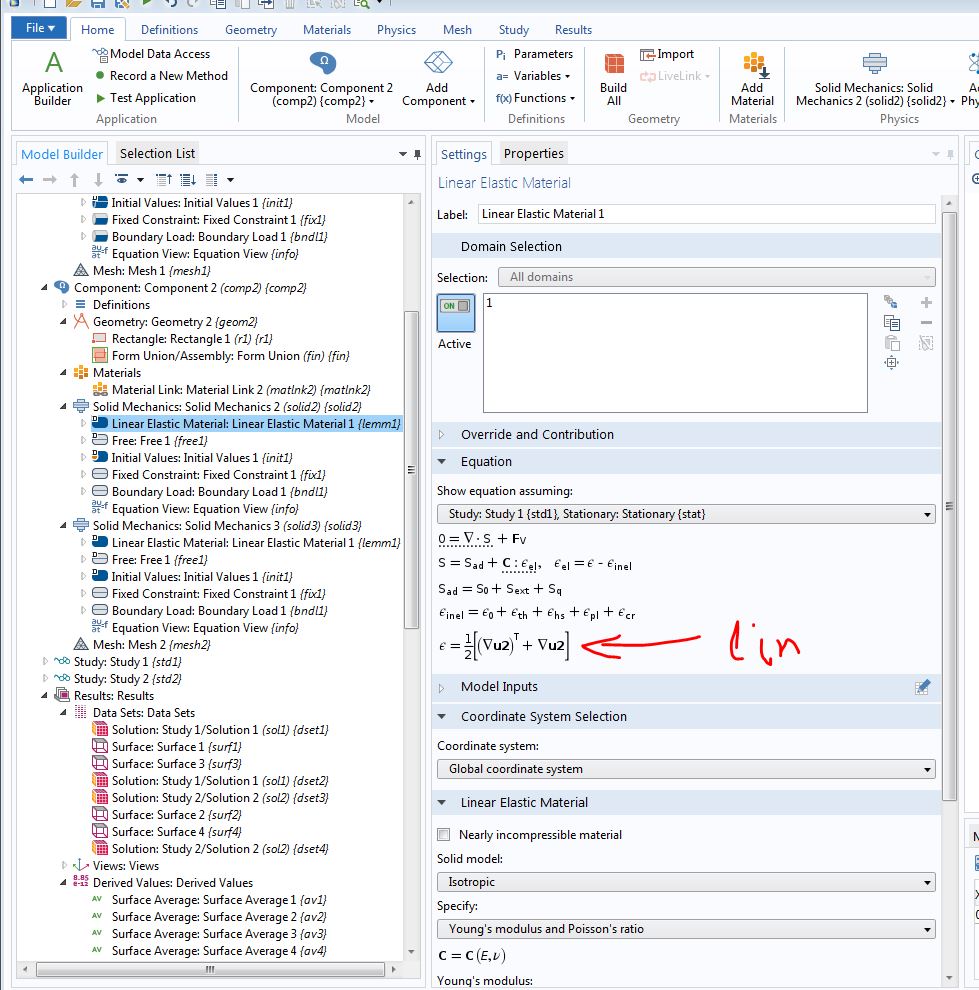

I'm not sure I catch really your question, but have you checked the doc/help under "Analysis of Deformation" and the related sub pages ?
I have also added a "toy model" to check that the spatial x,y,z and material X,Y,Z do link via the deformation u,v,w, but only if the geometric nonlinearity is "on" else they are equal.
This "toy-model" also illustrates the differences between 3D solid, 2D Solid in Plane Strain and Plain Stress, and how these compare to the mid plane of a 3D solid and to the outer edge. My material is artificial, just there to give some large deformations
To better understand check the equations that COMSOL uses (see the jpg below, I believe you must turn on the Equation Section via the *eye* icon in the model tree (by default COMSOL hides many features to make the model tree look simpler, that is best when you start with COMSOL otherwise one tend to get lost in the thousands of menus ;)
Hi I'm not sure I catch really your question, but have you checked the doc/help under "Analysis of Deformation" and the related sub pages ? I have also added a "toy model" to check that the spatial x,y,z and material X,Y,Z do link via the deformation u,v,w, but only if the geometric nonlinearity is "on" else they are equal. This "toy-model" also illustrates the differences between 3D solid, 2D Solid in Plane Strain and Plain Stress, and how these compare to the mid plane of a 3D solid and to the outer edge. My material is artificial, just there to give some large deformations To better understand check the equations that COMSOL uses (see the jpg below, I believe you must turn on the Equation Section via the *eye* icon in the model tree (by default COMSOL hides many features to make the model tree look simpler, that is best when you start with COMSOL otherwise one tend to get lost in the thousands of menus ;) -- Good luck Ivar
