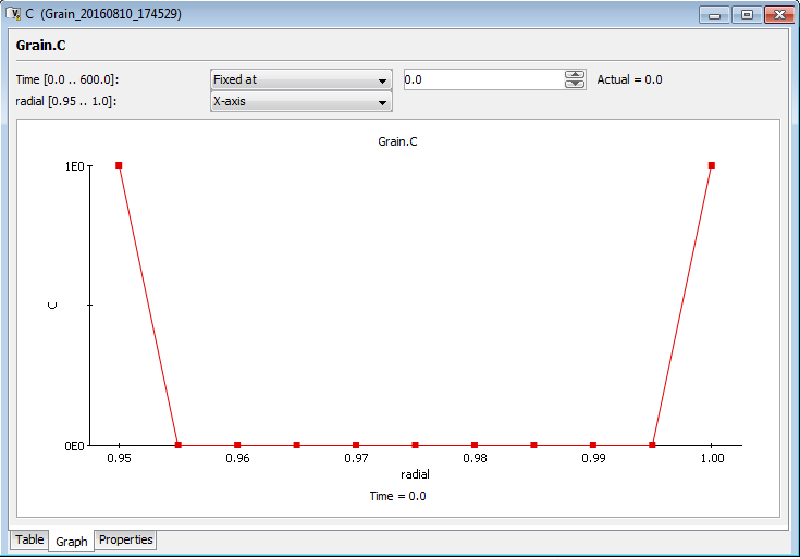

I am trying to solve a simple 2nd order differential equation. I see that the profile does not satisfy the initial values given.
I have attached my comsol model file while the expected result that I got using another software is also attached.
Any help is appreciated

Without looking at your mph file, it looks like a classic case of imposing BCs that are inconsistent with initial conditions. You will find several threads on the Discussion Forum where this is discussed, including this one: www.comsol.com/community/forums/general/thread/32944 .
Hello Vishnu, Without looking at your mph file, it looks like a classic case of imposing BCs that are inconsistent with initial conditions. You will find several threads on the Discussion Forum where this is discussed, including this one: https://www.comsol.com/community/forums/general/thread/32944 . Best, Jeff

Yes the step function did the trick.
