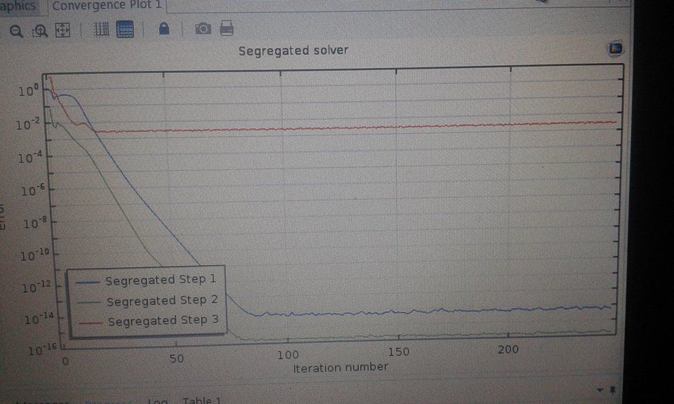

I use turbulent _epsilon with low-reynolds number as you advised me,but still have problem in solving ,as you can see from attached picture " time consuming with out finish ".

Dear Frank , Thank you to quick reply !! I use turbulent _epsilon with low-reynolds number as you advised me,but still have problem in solving ,as you can see from attached picture " time consuming with out finish ". best regards, hussein
