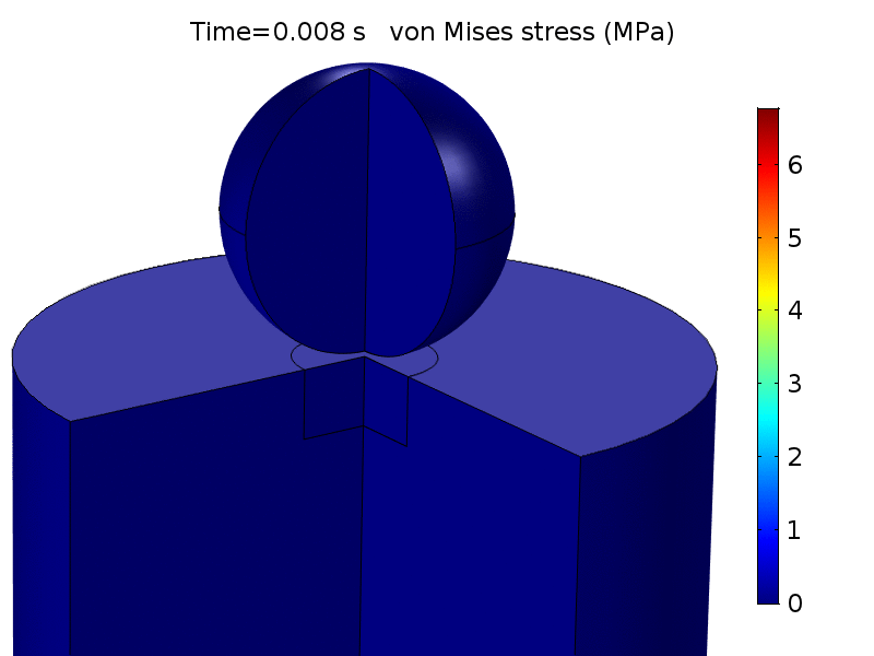

I would start with one of the COMSOL tutorials about Contact (that requires the Structural Mechanics module). An initial velocity is assigned using the “Initial Values” node. The main challenge for this problem is handling impact (as opposed to stationary contact). The default contact settings in COMSOL are good for stationary contact (that is well documented in the manuals), so you need to make some modifications. To solve this type of problem I use a penalty contact formulation (instead of the default Augmented Lagrangian) and select a suitable penalty stiffness that does not lead to excessive penetration or energy instability. I tried to attach an animation of such a model for you but for some reason can’t do it.
Nagi Elabbasi
Veryst Engineering
Hi Alec, I would start with one of the COMSOL tutorials about Contact (that requires the Structural Mechanics module). An initial velocity is assigned using the “Initial Values” node. The main challenge for this problem is handling impact (as opposed to stationary contact). The default contact settings in COMSOL are good for stationary contact (that is well documented in the manuals), so you need to make some modifications. To solve this type of problem I use a penalty contact formulation (instead of the default Augmented Lagrangian) and select a suitable penalty stiffness that does not lead to excessive penetration or energy instability. I tried to attach an animation of such a model for you but for some reason can’t do it. Nagi Elabbasi Veryst Engineering
Posted: 8 years ago 8 set 2016, 11:41 GMT-4
Here it is!
Here it is!

I am a student and I am new to COMSOL. Now day , I am building this model, but I find it is too diffucult for me to make this application. Could you give me a help? I want to know how to build that mph in your reply-- Cylinder_Dynamic_Anim2.gif

Hi, I am also very intersted in how to build the impact model as you have posted in your reply. I am currently doing some research on acoustic emission generated by the impact. I have read some your discussions with other reseachers on Structual Mechanical and Acoustic Emission and learnt the COMSOL tutorials that you recommended about penalty contact formulation (Snap Hook, Adhesion and Decohesion of Indenting Ball... ).
My question is how can I model the acoustic emission signals generated by the impact? I notice that your model contains the rebound stage of the ball. Did you consider the adhere between the cylinder and the ball? How should I choose a suitable penalty stiffness? I am wondering if you have some paper or other referrences explaining these problems and I can learn more from them.
