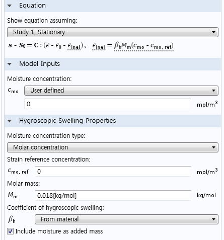

Hi. Please help me out.
In hygroscopic modelling, the moisture concentration is given in mole/m^3.
In case I have a relative humidity of 40% at a temperature of 25 degrees Celsius, how do I convert this into mole/m^3.
Thank you.

By the way, you can also select to give the input in terms of mass concentration.
Either way, the humidity in in the surrounding air serves as a boundary condition for the moisture concentration in the solid you will analyze. It is not trivial how to transform the values in the surrounding air to values inside the solid.
