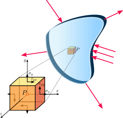

there are 2D approximation in structural mechanics. so i'll use plane stress condition.
in comsol document and forum, z-direction is out-of-plane direction so stress of z direction is zero.

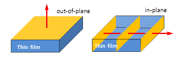

but in my model, i make y direction to out-of-plane direction.
in my model is cross-section view of xz-plane in attatched file.
what i wonder is plane stress condition make z-direction only out-of-plane direction.
i change thickness to know where is out-of-plane direction. but i don't know where it is.

thanks for your answer.
in comsol document, plane stress condition has no stress of out-of-plane direction(z-direction).
and thickness of z-direction is very thin.
but my model has very thin thickness of y-direction. so i think z
in plane stress condition, the length of specific direction is not considered?
thanks for your answer. in comsol document, plane stress condition has no stress of out-of-plane direction(z-direction). and thickness of z-direction is very thin. but my model has very thin thickness of y-direction. so i think z in plane stress condition, the length of specific direction is not considered?
