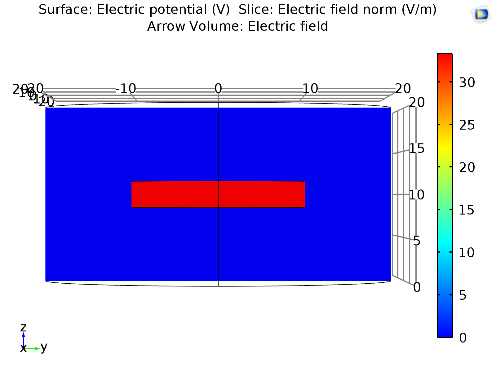

I've tried a simple case using COMSOL's capacitor example (www.comsol.com/model/computing-capacitance-12689). Instead of using "form union", I used "form assembly" to perform the calculation. However, the simulation doesn't calculate electric field or potential between different metals. I think this results from meshing the geometry.
I've attached described result and the simplified model in the attachment.
