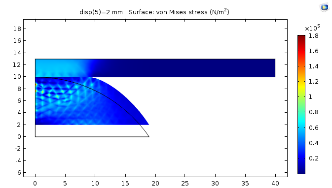

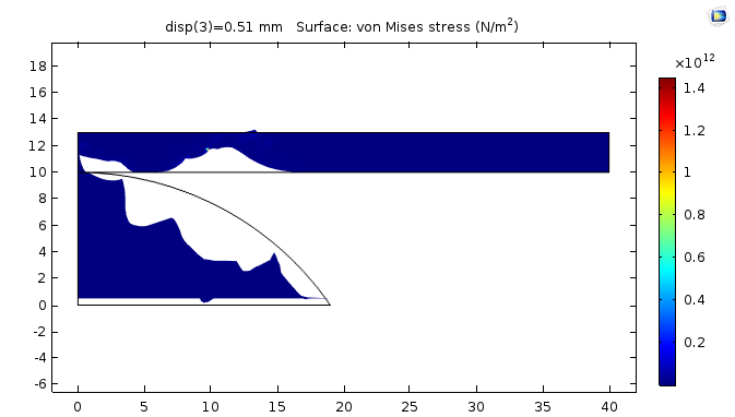

Thanks for your reply, Jeff
Y and P are variables with the expression Young and Poisson respectively because I wanted to include these in my table.
As for using the nearly incompressible material option, this causes even less convergence and stranger solutions such as the one attached
