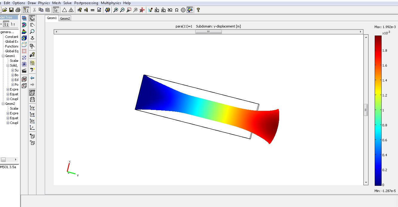

I'm trying to model the simple uniaxial tansion of a neo-hookean hyperelastic beam, and i have some problems about the bounday contrain.
I fixed an extremity and i impodes a ditribuited load at the othe end. The problem is this last end: infact i would like to constrain both ends of the strip, in a such way the loaded end can't deform in any direction.
I tried the roller and the axial simmetry constrain, and the prescribed displacement, but the problem remain.
In attach the fugure of the deformed shape of the beam. What can i do to prevent the deformation of the face in the load direction?
Thanks a lot for your help!
Sandra

if you want to impose that the loaded edge remains "straight", then you should look up the example in the 3.5a doc about a rigid edge beam, but I do not remember exactly in which doc it is ;)

Thank you Ivar!
I found the example you suggest in Structural Mechanics Model User's Guide, and also I found this topic in the forum
www.comsol.com/community/forums/general/thread/7961/
But in my case, the domain to be "stright" is not an edge, but a face, and i work whit the Structural mechanics->solid stress-strain module, so i didn't understand how i can apply the edge example.

well if you are in true 3D then you boundaries are 2D, indeed you need to adapt the example from the 2D (1D boundaries=edges) to faces
By the way in 4.1 you have the RBC (rigid boundary conditions) that will do it for you
