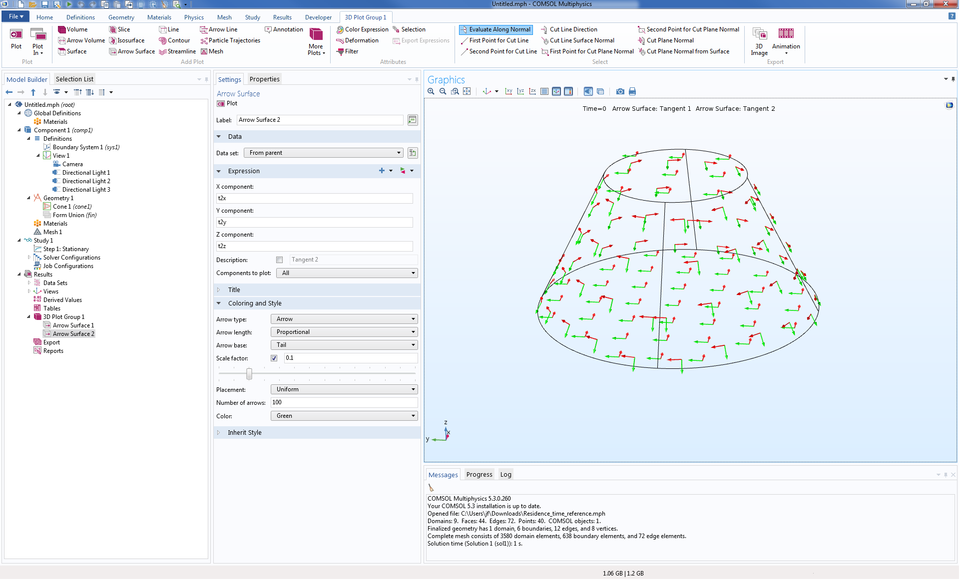

t1 and t2 are literally two vectors that are tangential to the surface at the point in question. How they are computed from the parametrization of the surface is explained on the page I listed earlier. In the general case, they are not aligned with a particular axis, which is why they will usually have three non-zero components along the x, y and z axes, denoted, for t1, t1x, t1y and t1z (and same idea for t2) as mentioned above. You can use an Arrow Surface plot to visualize these vectors using those component names, see attached screenshot showing t1 in red and t2 in green for a cone.
Perpendicular to both t1 and t2 is n, the outward-pointing normal vector, with components nx, ny and nz.
