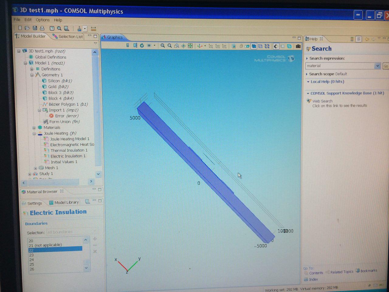

Posted: 7 years ago 17 ago 2017, 14:40 GMT-4
Sorry, Aria, I am out of ideas. As far as I can recall - and admittedly I have not used 3.5a in many years - there is no way to disable the menu bar.
Can you post a screenshot of what the GUI looks like for you?
Jeff
Sorry, Aria, I am out of ideas. As far as I can recall - and admittedly I have not used 3.5a in many years - there is no way to disable the menu bar. Can you post a screenshot of what the GUI looks like for you? Jeff
Posted: 7 years ago 17 ago 2017, 14:45 GMT-4
Yes, sure. It is attached.
Boundaries are shown in the left bottom corner but I can't define them.
Yes, sure. It is attached. Boundaries are shown in the left bottom corner but I can't define them.
Posted: 7 years ago 17 ago 2017, 14:52 GMT-4
That's not version 3.5a. It's some flavor of version 4.
The GUI changed thoroughly at version 4.0, so you won't be able to follow instructions written for 3.5a with this 4.x installation.
Best,
Jeff
That's not version 3.5a. It's some flavor of version 4. The GUI changed thoroughly at version 4.0, so you won't be able to follow instructions written for 3.5a with this 4.x installation. Best, Jeff
