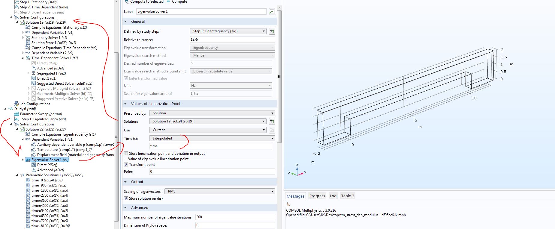

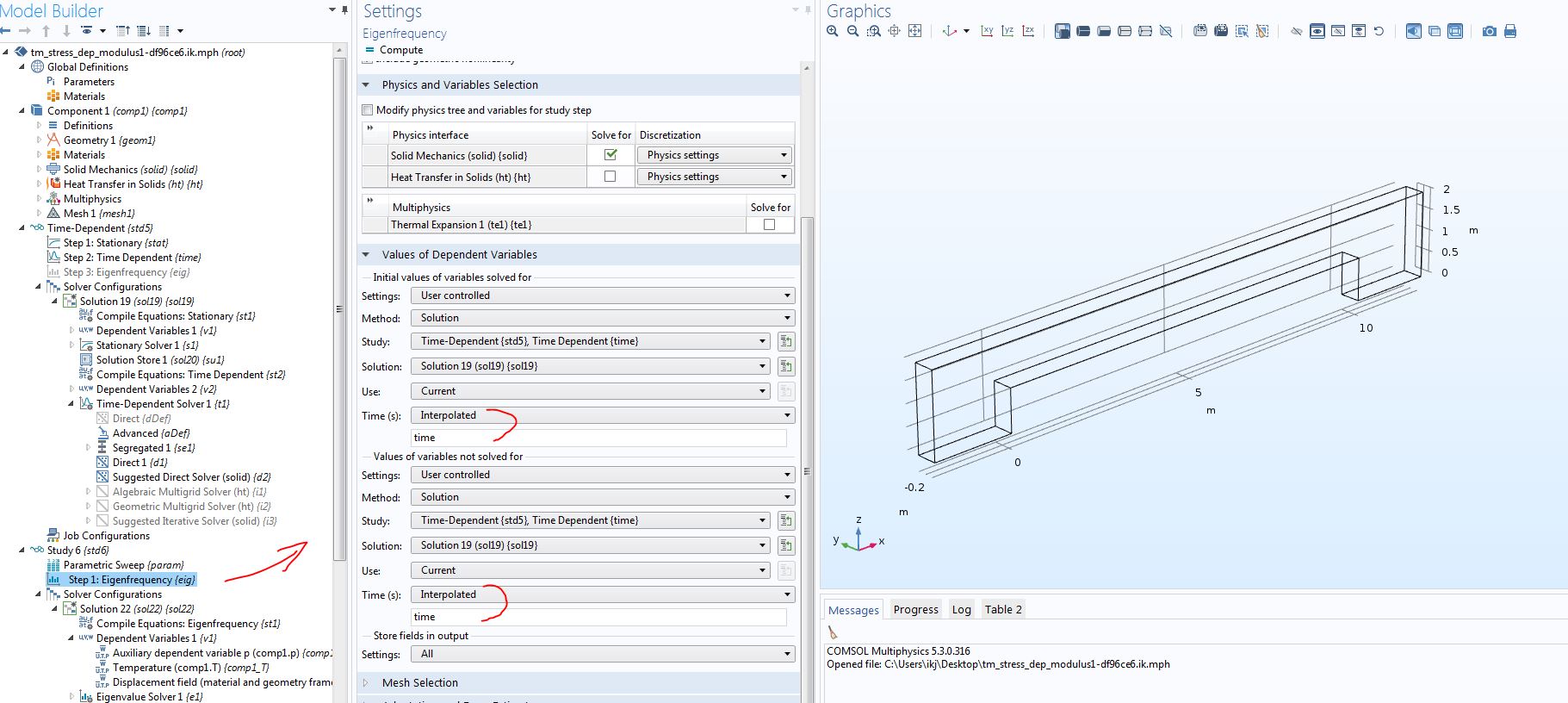

Ivar KJELBERG
Posted:
8 years ago
23 set 2017, 01:49 GMT-4
Updated:
8 years ago
then probably its the "index" into the time solution or the "time pointer" that did not get up correctly, in both Derived variables initialisation AND in the Eigenfrequency solver node initialisation settings. see the images below, I have only the latest version of COMSOL active.
By the way your mesh is a bit coarse cehck your CFL number.
Sincerely Ivar
Have fun COMSOLing,
Sincerely,
Sincerely Ivar
