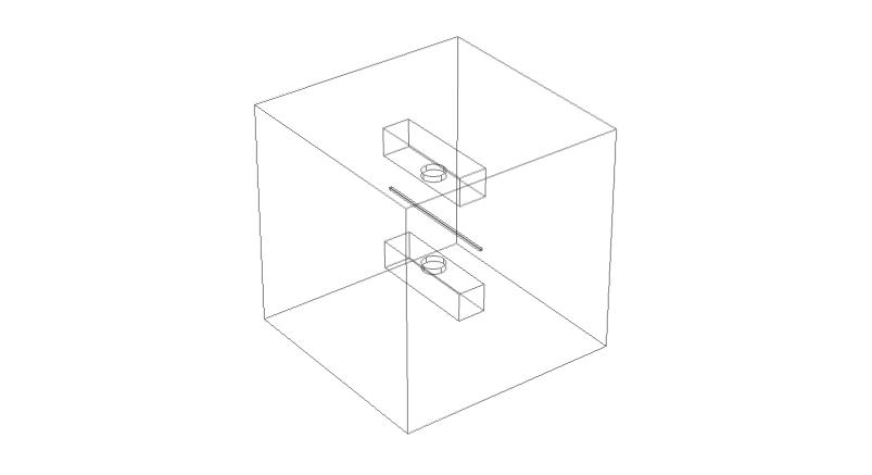

Hi, I'm currently trying to manipulate the external force in Navier Stokes Equation and having some trouble. In my model there are two identical permanent magnets that are attached to 2 rotors. in between the rotors there is a tube filled with ferrofluid. I'm trying to make fluid flow using the magnetic force between two magnets but I can't figure out how to use the force I calculated from the Magnetic Fields. No Current physics into Laminar Flow physics. Is there a way to manipulate the external force in the equation?
Any help would be much appreciated! Thank you.
