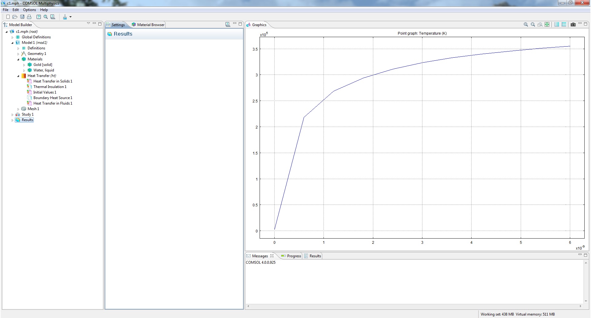

I ran the simulation and obtained results in the 350,000 K region as you can see in the picture I provided. The values obtained experimentally were 1500 K so I am way off.
Am I still missing something in my model? I have not yet added the convection process but would this be enough to drop the temperature by 2 orders of magnitude?

the radiosity is for radiative exchange, normally at a few hundred degrees of temperature difference the radiative emission of a body is relevant, so you might need to consider it, at least as an exercise. Because I'm not sure for your small sizes the scaling law would make radiative exchange so important. To be checked. Use the blackbody Stephan Boltzman law, i.e. as described here
en.wikipedia.org/wiki/Stefan–Boltzmann_law
Do not forget that it uses the difference in temperature in Kelvin ;) and with a T^4 relation it is very non linear

The drop in temperature was significant, it dropped by 2 fold. Now my max temperature is 1.4 x10^5. Still two orders or magnitude too high.
I will now try to add in convective cooling and see how that goes.
Thanks.
convection is normally a few W/m^2/K I'm not sure that will give you a big difference, because of your small scale, but always worth to try. Often its also useful to do some hand calculations to get the orders of magnitude
Thanks a lot for your input. I was able to get the model very close to experimental data. You are right, adding in convection barely changes the temperature distributions.
