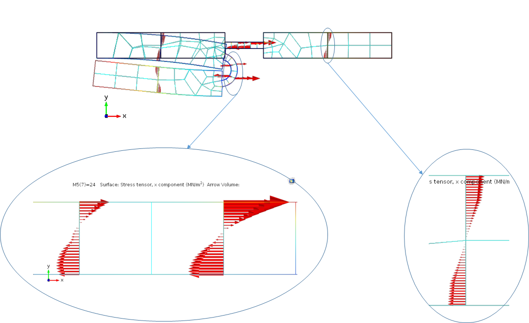

Hi Jovana,
Can you please specify what type of diagram you are looking for? It may be the Stress Linearization feature you need, or just a Slice Plot in a 3D plot group.
Do you need stress components in a cross section local system?

Hi Henrik,
I attached a photo where you can see the type of plots/diagram that I would like to generate.

Hi Jovana,
It seems like you want a Arrow Surface plot of the traction vector, (solid.Tax, solid.Tay, solid.Taz).

Hi Henrik,
Thank you for your help.
