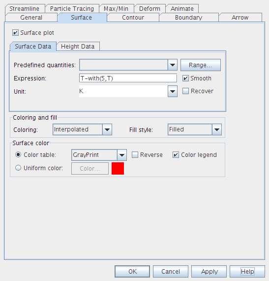

Thank you Jean-Francois, I used the following in the Plot Parameters dialogue box, 'Surface' tab, Expression field:
T-with(5,T)
and got something like what I was expecting.
