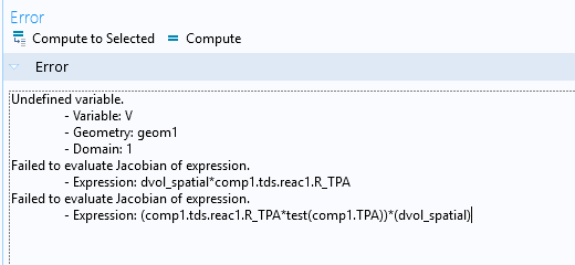

Thank you. Now when I compute Study 2 after Study 1 I get an error "Undefined variable. - Variable: V - Geometry: geom1 - Domain: 1."
I have attached my program and a screenshot of the error.
Thank you. Now when I compute Study 2 after Study 1 I get an error "Undefined variable. - Variable: V - Geometry: geom1 - Domain: 1." I have attached my program and a screenshot of the error.

The error that you see comes from the use of the field variable V in the global Variables node. Such space-dependent variables cannot be used as global variables. If you instead define the variables in a Variables node under** Component 1>Definitions**, then you can compute Study 2. The species concentrations seem to be constant in that solutions though; that is not something that I have investigated.
