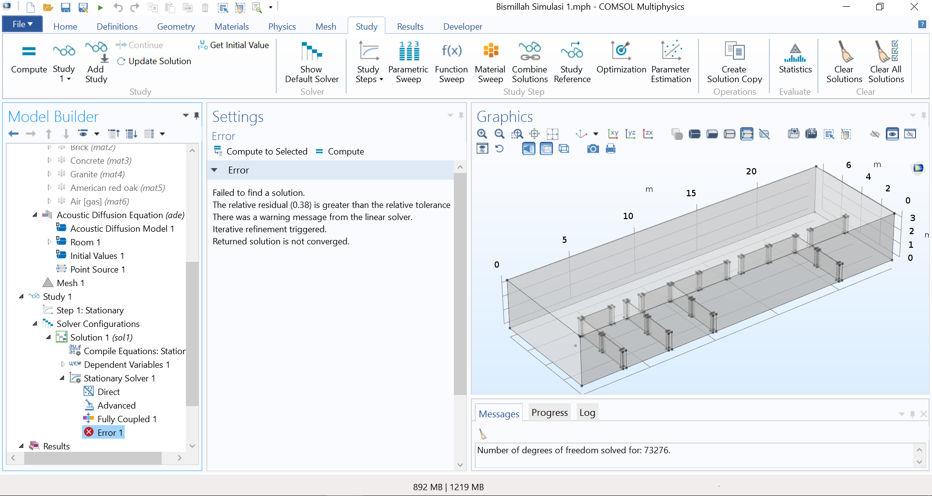

Thank you for your prompt reply. It is very helpful. I have followed the the model which you showed to me. However, i have the other problems. It said failed to find solution. It happen when i computed the stationary study. Do i need to define the power source in all band number?
Kind regards, Ainun Nadiroh
