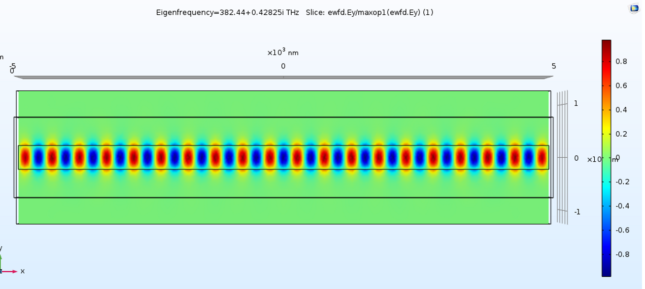

Attached is a TE10 mode propagating in a semiconducture waveguide, surrounding by air and with PML to give you an example. I did it in 3D.
