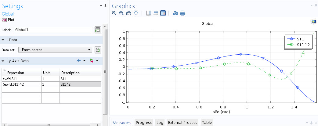

Hello my freinds, (^2) can change negetive sign to positive but why we should use ”abs” before for example; abs(ewfd.s11)^2 to calculate norm of S11?

Dear Nichal, ewfd.S11 is scalar matrix. it can be real ,complex, positive or negetive but here, this matrix is real and mixed of positive and negetive numbers. I dont know why (ewfd.S11)^2 has negetive number ?

I guess there is some confusion about the S-Matrix. The dimensions of the S-Matrix depends on the number of ports the system has. S11 is one scalar element of the S-Matrix characterizing reflections from port 1. It is in general a complex number and that is why S11^2 can be negative.
