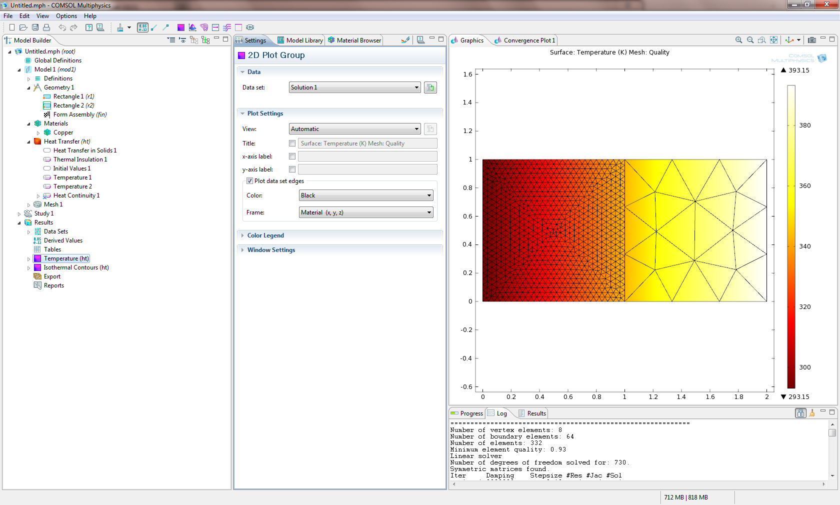

I have an assembly that has components size varying from few microns to a mm. I want to mesh it such a way that the larger components will have large element and connected to smaller elements without transition elements. How can I achieve this in comsol? In FEM as I recall there is something called super element. How can I create such a super element in comsol?

It's indeed possible. The "trick" consists in using an assembly and an identity pair. See the attached screenshot for an example illustrating that approach.

Hi Jean,
I did not see any attached screen shot. I would appreciate if you can resend it.
Susant
Hi Jean, I did not see any attached screen shot. I would appreciate if you can resend it. Regards, Susant
Posted: 1 decade ago 27 giu 2011, 16:15 GMT-4
Sorry, he it is.
Sorry, he it is.
