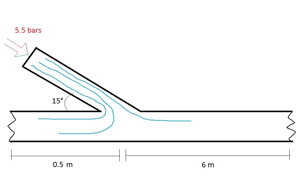

Hi again,
I have to model a flow of nitrogen inside a tube (interior diameter = 12 mm) and all I am given is the inlet pressure (5.5 bars), and the pressure at the other side of the tube is ambiant pressure. The tube is 6.5 m.
The issue I'm facing is that the solver can't find a solution if I just put an inlet and outlet with pressure, no viscous stress as BC. I have a solution with really weak pressure differential (10 Pa) or weak inlet velocity (1e-2 m/s) but these are far away from my own conditions. It's important to notify I tryied both laminar and turbulent flow.
I know it has been discussed a few times in the forum but I wasn't able to find a thread resolving my problem. I don't know if I missed something in comsol or simply with the actual phenomena.
If someone knows what I could do, thank you very much!!

It is possible to obtain a solution with your conditions and laminar flow interface by using some artificial diffusion, the ''inconsistent stabilization' tab under 'laminar flow'. Using a 2D axisymmetric geometry with a rectangle of 6mmX6.5m and 0.25 isotropic diffusion and nitrogen gas from comsol library, you would get a max velocity of abot 45 m/s.
However, you need to try to reduce the isotropic diffusion as well as try to understand whether it's laminar or turbulent by using the Reynolds number you may calculate from the velocity resutls.

So I have now a solution (thanks a lot) but I doubt of its relevancy (I have a max velocity of 296 m/s), and I wonder how does this 'inconsistent stabilization' option affect on calculations. As a matter a fact my model is slightly more difficult than a simple tube (I used this tube model only to understand the phenomenon) because I have 2 exits (see attached file), and even before knowing the behaviour of the flow, it seems obvious to me that results are false.
So if I got you well, you said that the stabilization helps the solver finding a solution, but not really accurate, and in order to be more precise I have to remove progressively this stabilization??
