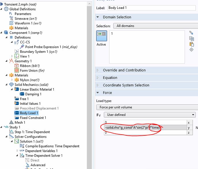

Hi I am looking for nonlinear (geometric) large deflection response and I think time dependent would be most apt.
I am trying to apply the load (base excitation) as a body force (as shown in the snapshot attacked to my 1st post). Any suggestions?

You can type a mathematical expression like the one in your screenshot, but the variable for time is "t", not "time".
Jeff Hiller
You can type a mathematical expression like the one in your screenshot, but the variable for time is "t", not "time". Best, Jeff
