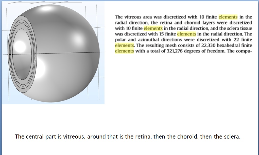

Hello, I am trying to replicate the results from a paper. I am having problems with the mesh. I have attached a photo with the geometry and a description for the mesh.
