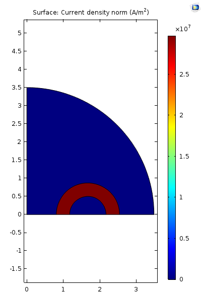

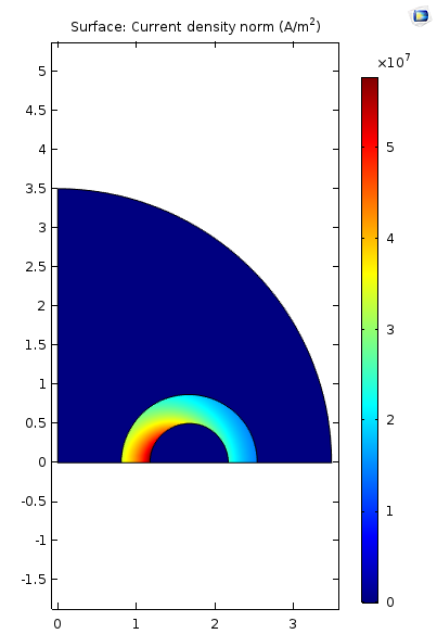

Sergei I was able to do what I wanted by prescribing {ec.Jx,ec.Jy,ec.Jz} from ec node in my axisymmetric model(Figure 1), thanks to your suggestion.
However, then I realized that it is not exactly what I need to do. What I need to do is prescribing homogeneous current density across the conductor as it happens for Comsol's coil feature with homogenized multi-turn conductor model, as shown on Figure 3 for circular geometry of conductor. I can use coil feature with homogenized multi-turn conductor model in 3d, but can't do it in 2d axisymmetric setting, as coil feature works only for out-of-plane components of current density, while I'm interested in prescribing in-plane components Jz and Jr. I was wondering if you know if there is any way to prescribe homogeneous in-plane current density along the conductor 2d?
Thank you!
