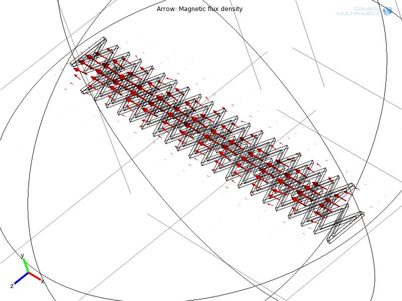

In the picture which is attached, I plotted arrow volume under 3D plot group.
What I need is the output of a value of the magnetic field [B] between the wires,
I think that is anyway what is already plotted in my simulations.
I have found the value of the magnetic field in the wires but not between them.
If you could help me, I would be grateful for it.

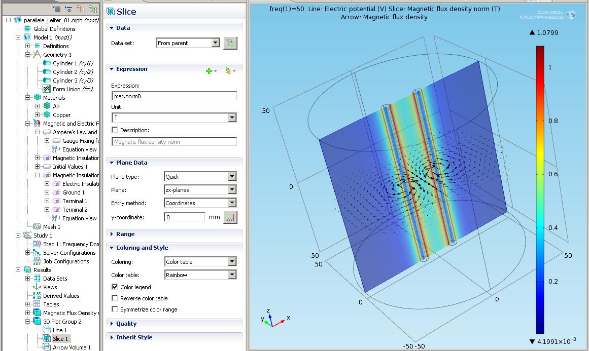

Do you want something like the attached image?
This is a slice in a 3D plot group.
Ralf
Hi Marta! Do you want something like the attached image? This is a slice in a 3D plot group. Ralf
