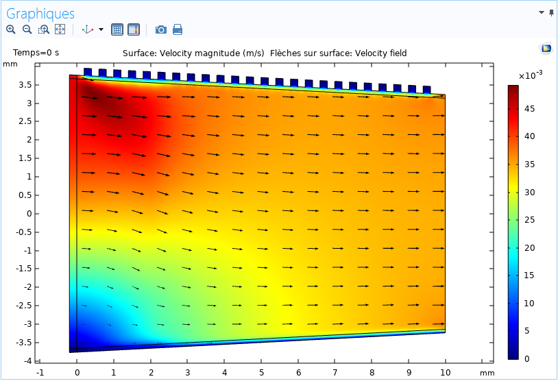

However in my results, it seems that only the initial values of my first domain are taken into account in all the geometry, and I cannot really understand why. Has anybody faced the same issue and can maybe give me some advice on this ?

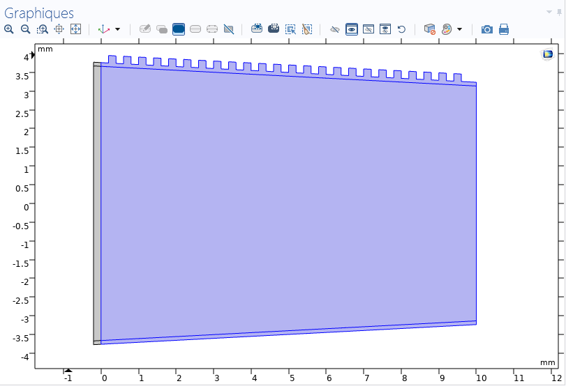

I hope I have been clear enough ! Here are some photos of my geometry : - The first one shows the speed at time t=0s where I think I should see no speed in he second domain - The second one is to show the two domain I am working with Thanks in advance for your help !

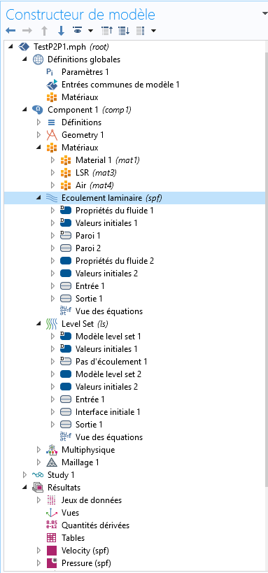

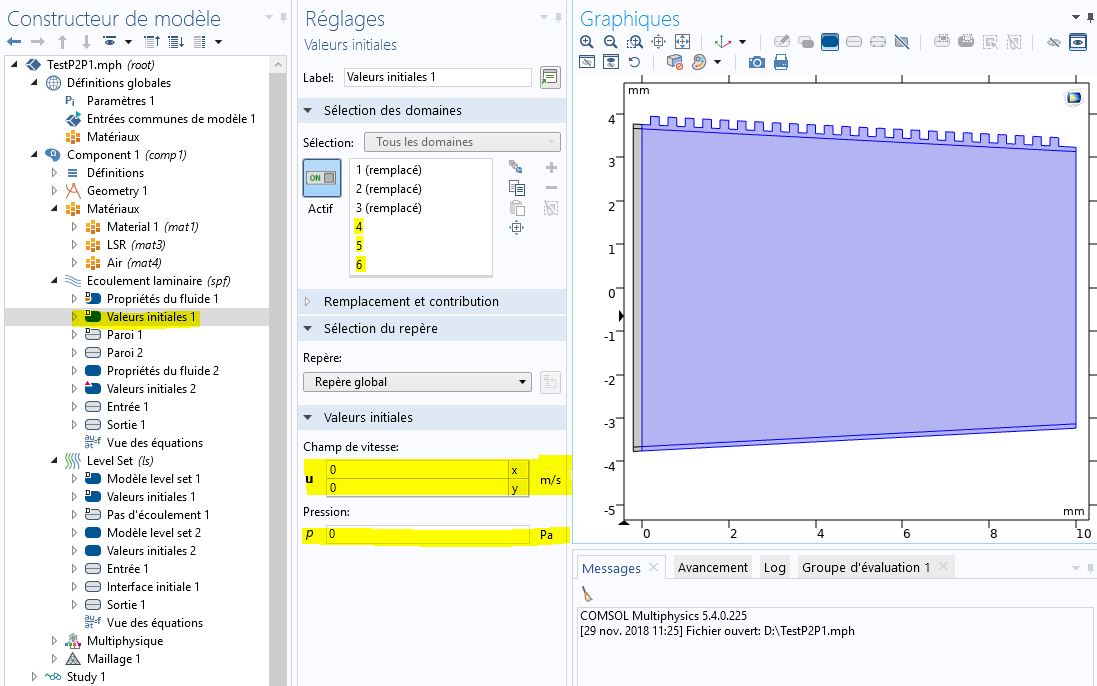

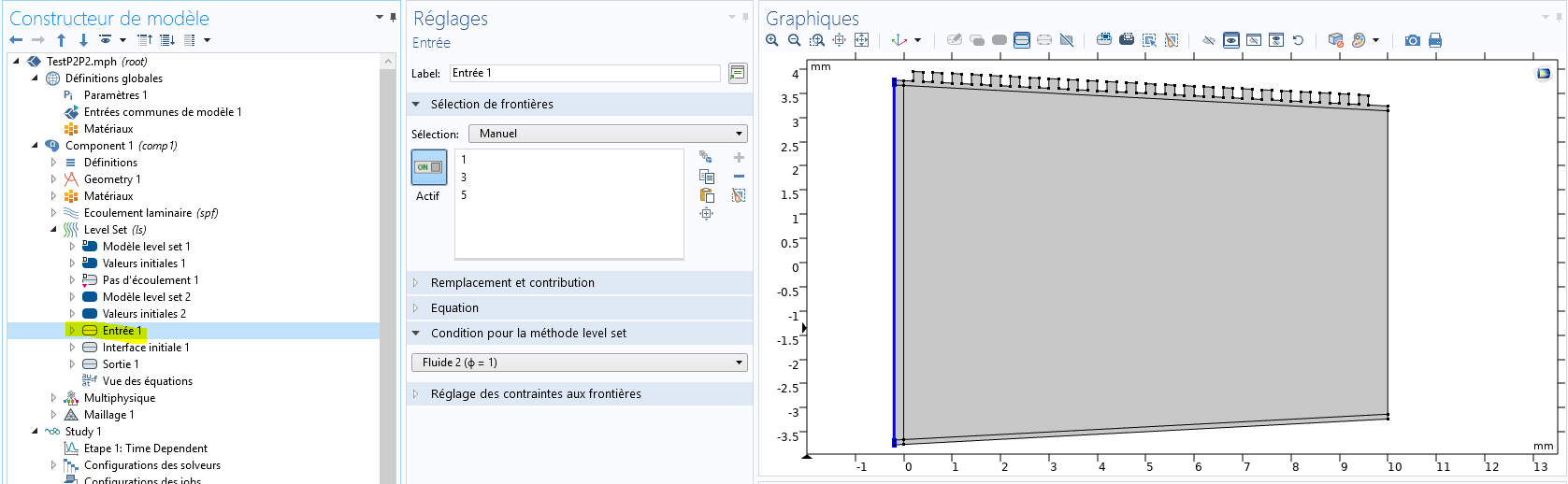

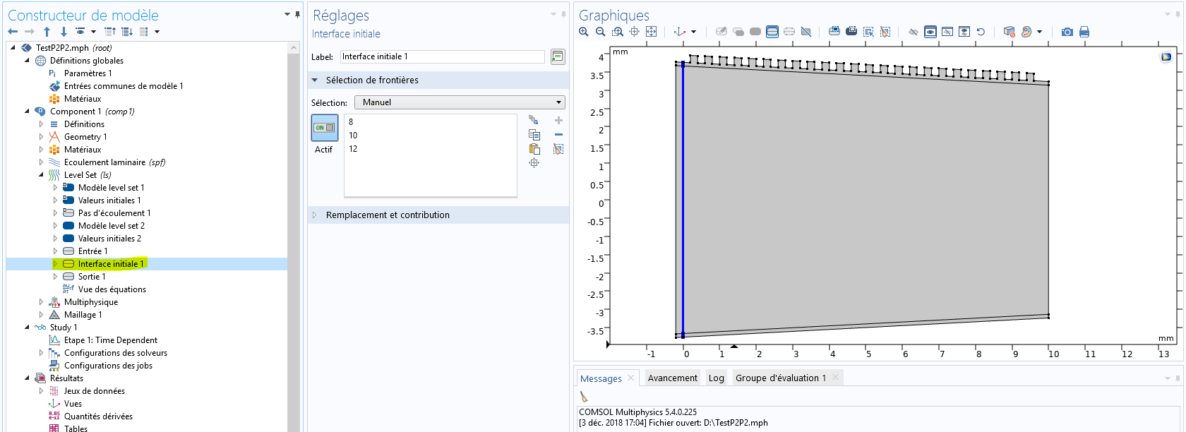

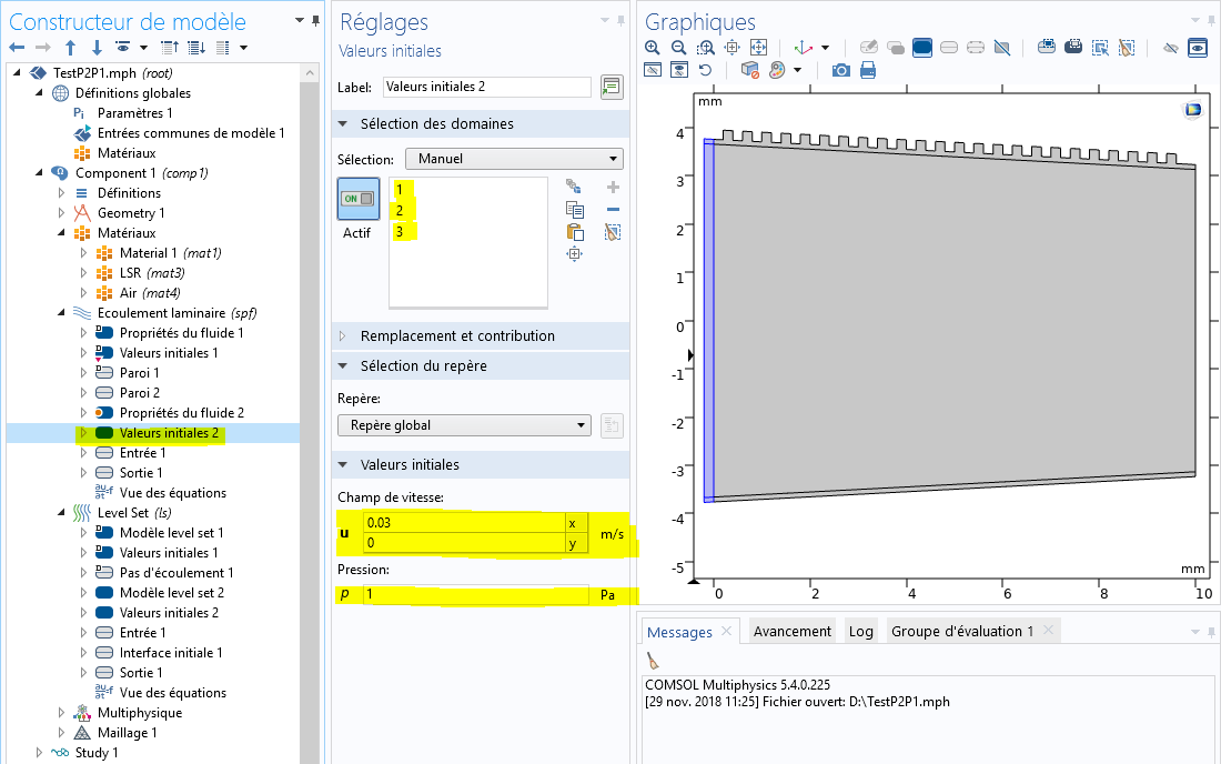

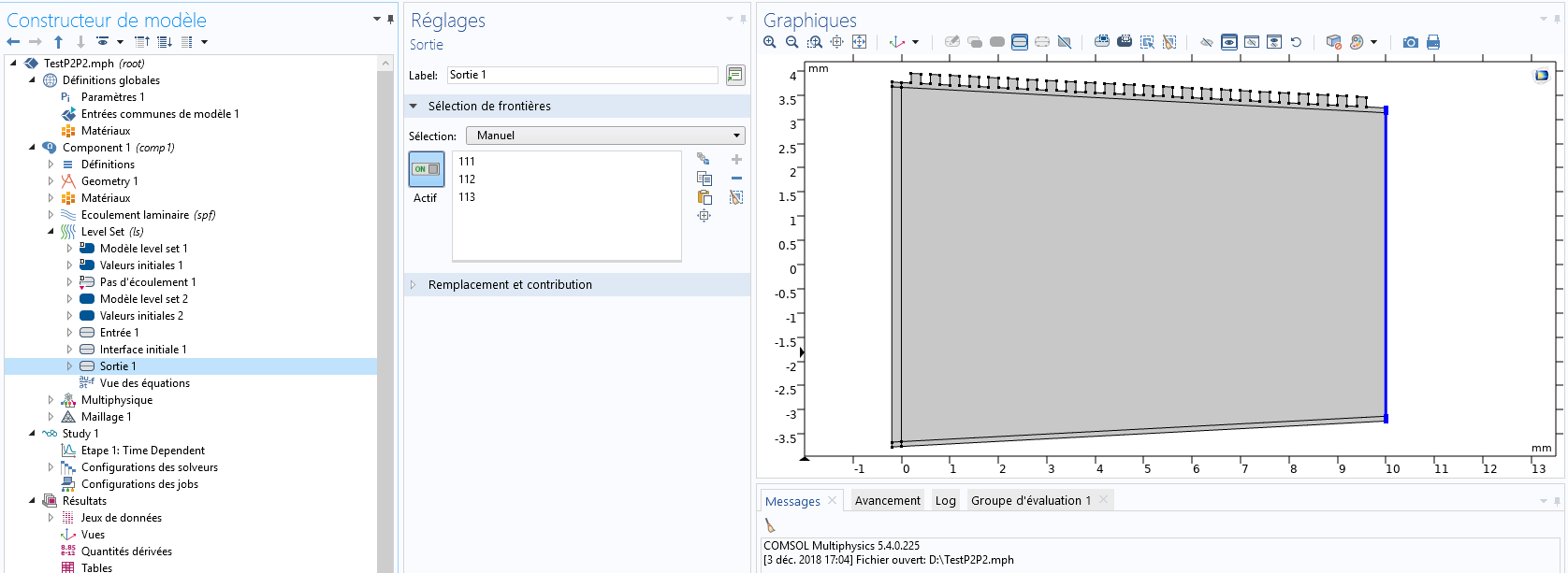

(see forumComsol3.png) Laminar flow (spf) - Fluid properties 1 - Initial values 1 (see forumComsol4.png) - Wall 1 - Wall 2 - Fluid properties 2 - Initial values 2 (see forumComsol5.png) - Inlet (see forumComsol6.png) - Outlet (see forumComsol8.png)
Level set (ls) - Level set model 1 - Initial values 1 - No flow 1 - Level set model 2 - Initial values 2 - Inlet (see forumComsol6.png) - Initial interface (see forumComsol7.png) - Outlet (see forumComsol8.png)
So my initial values 1 has the velocity u = 0 m/s and the pressure p = 0 Pa, and my initial values 2 has the velocity u = 0.03 m/s, and the pressure p = 1 Pa. This is what I meant when I talked about steps. I thought that it would be logical to have a speed equal to zero in the bigger domain since I have initial values at 0 in it, however the results seem to show that I have a speed near 0.03 m/s in all of the geometry at time t=0s (see forumComsol.png). So this is my issue.
