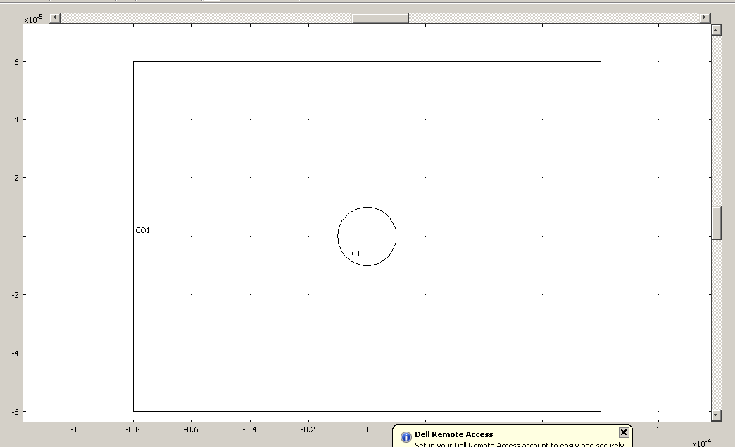

I wish to model a muscle tissue (solid domain) which contains a capillary blood vessel (fluid domain). I’m not interested in the blood flow.
The geometry is in the attached file.
I want to model the pressure the fluid is exerting on the vessel wall (blood pressure). At first I thought of using the structural mechanics modulo alone, using the load option in the subdomain settings , but as this load is force/length or force/area it is not suitable for me to use…. (blood pressure is in Pa and can’t be translated to N/m2 as the dimension of depth of the cardiovascular system are not proper to model…)

Well, actually I have made some progress since my message was posted. I’ve realized I can change the thickness of the cross section: I’ve changed it to 150 ?m, so now it fits better with my model dimensions (160 ?m *120 ?m). After changing the thickness I found it logical to use the blood pressure value…
As I’m not interested in the blood flow but rather interested in the heat exchange and the load blood exerts on the vessel wall, I’ve decided not to use the fluid application: I’me using the structural mechanics plane strain modulo and bioheat equation from the heat transfer.
