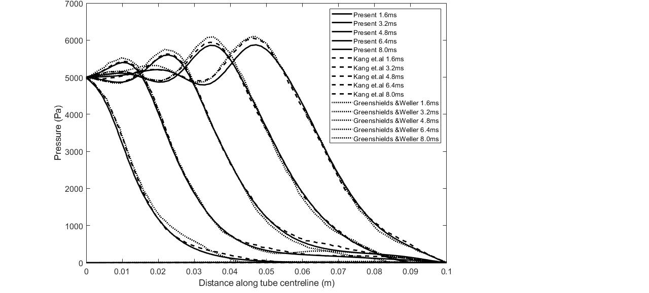

I am trying to simulate a 3D FSI flow through a flexible pipe. I have done a 2D axisymmetric version of the same problem and got results which matches with the previous literature. References S. Kang, H. G. Choi and J. Y. Yoo, Investigation of fluid- structure interactions using a velocity-linked P2/P1 finite element method and the generalized- a method, Interna- tional Journal for Numerical Methods in Engineering, 90 (2012) 1539-1547. Greenshields CJ, Weller HG. A unified formulation for continuum mechanics applied to fluid-structure interaction in flexible tubes. International Journal for Numerical Methods in Engineering 2005; 64:1575–1593
Its the propagation of a pressure wave of 5000Pa in the tube at different times. The radial displacement of the outer wall also matches well with the published literature.
But the same problem with the same BC while simulating as 3D the pressure wave dies off faster.ie the radial displacement of the outer wall is much less for 3D problem. Figure attached shows the BC i give.
Kindly help me out
