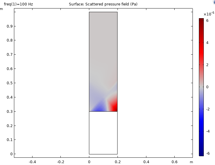

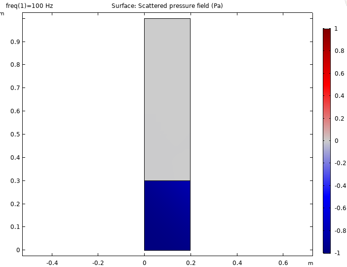

The Pressure Acoustics interface solves for the total field, acpr.p_t, which is the sum of the background, acpr.p_b, and the scattered, acpr.p_s, fields. That is to say, acpr.p_t = acpr.p_s in the domains without a background field. All three exist over the whole computational domain and can be visualized there. One thing is that the amplitude of scattered field can differ significantly in the domains with and without a background field.

  2. It is stored. Try to add the Selection node to your plots and choose different subdomains (see my screenshots of the acpr.p_s for the whole domain and a selection provided that a background field is only defined in the lower subdomain and mind my comment about its amplitude).
