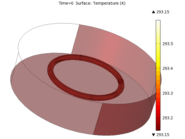

Hi Ivar,
It seems that the file indeed got corrupted somhow, I think. In another file which seems perfectly identical to this one, the computation worked(I increased the current as you suggested, by the way).
In these results, however, there seems to be something wrong. I attacked a GIF file to show you the result - it looks like a heat diffusion from certain places on the coil, and clearly it shouldn't be that way, since the problem is totally symmetrical. The only thing I could think of that isn't symmetric is the mesh - perhaps refining the mesh would help?
Thanks,
Shoval

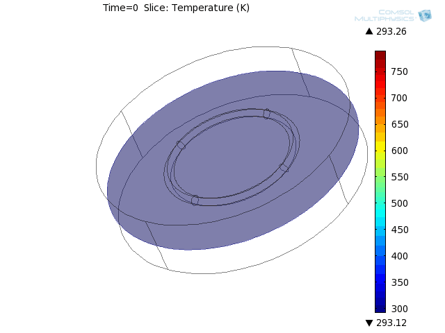

Posted: 1 decade ago 2 nov 2011, 10:50 GMT-4
Well the step function did not change a thing in the results. I'm definitely dazzled by the asymmetry here.
I attached the model as it is now, perhaps you can see why it is wrong. I noticed that you said earlier that you're using 4.2a - maybe it makes a difference - I'm using 4.2.
I also noticed that the current results, has at times areas with temperature lower than 293.15, the default for all the domains. clearly something is wrong. I cleared solutions to minimize file size - computation should take around 90 seconds.
thanks again,
Shoval
Well the step function did not change a thing in the results. I'm definitely dazzled by the asymmetry here. I attached the model as it is now, perhaps you can see why it is wrong. I noticed that you said earlier that you're using 4.2a - maybe it makes a difference - I'm using 4.2. I also noticed that the current results, has at times areas with temperature [i]lower[/i] than 293.15, the default for all the domains. clearly something is wrong. I cleared solutions to minimize file size - computation should take around 90 seconds. thanks again, Shoval
