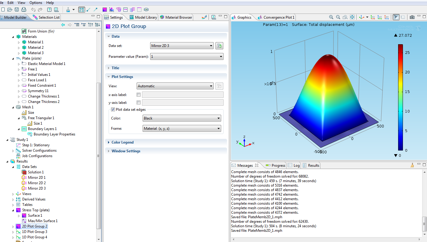

For a 1/8 symmetric model in 2D I have no problems to mirror 3x and get out a full 3D plot (v4.2a)
but this is not "cyclic" or ?

indeed the mirror implies local symmetry, while the rotation allows to repeat non symmetric shapes

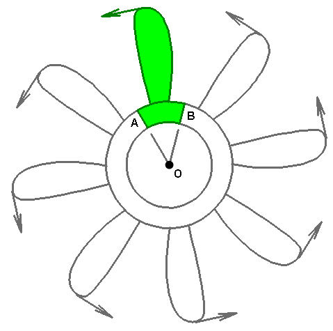

If a structure (including boundary conditions) has X sectors of rotational symmetry you can transform the full model into X/2 decoupled sub-models (via this cyclic symmetry transformation). If each sector has N degrees of freedom then solving the full system at once involves a solution of N.X equations. With the cyclic transformation, you solve instead N complex equations X/2 times. You can do this for linear stationary, transient and even eigenvalue problems. There is no loss of accuracy in this method.

this thread contains two questions:
1) For a sector-symmetric model, how do I map the solution of a 3D sector to a full 3D plot for visualization?
2) How can I do cyclic symmetry in structural mechanics? Cyclic symmetry for dynamic structural models can have different excitation modes in different sectors.
Attached is an example from the model library that answers both questions. The cyclic symmetry structural problem can be solved with Floquet boundary conditions on the cyclic symmetry boundaries. This model is a slightly involved in its implementation, but the good news is we will release a ready made physics interface for cyclic symmetry in the next major release, spring 2012.
Another improvement that is in the pipe are datasets that can be revolved, so you will not need to to use extrusion coupling operators to make the full 3D plot (see attached example for details).
Note: to get this model available in the model library, you need to be licensed the Structural Mechanics module, and perform a Model Library update.
