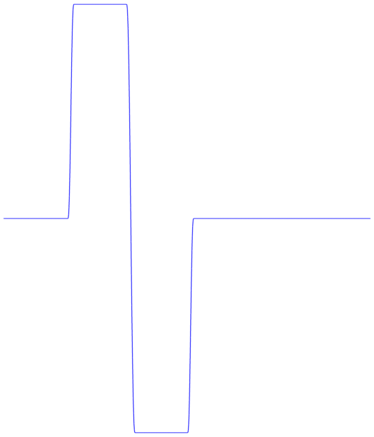

Now, I want to simulate a AC based system, with a rectangular shaped voltage pulse. Everthing is going perfect and smooth, but the magnetic field genrated is not similar to that of DC, infact I am unable to see any magnetic field lines in the whole system.
Is it the time step I should be concerned of? The direction of applied current and produced magnetic field (using Arrow line) does change like an alternatic current when I run the animation, but I am not able to generate the magnetic field lines (streamlines), like that of DC.
Could any one guide me and explain me where my AC simulations are going wrong? I would really appriciate your help. ! Attached a image of rectangular pulse shape.
