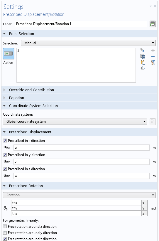

I don't have the Multibody Dynamics module. I can use method number 3. How can I impose a fixed relative displacement and the mobile absolute displacement (typical of the internal hinge)?

I am not sure that I interpret your question correctly, but in the attached screenshot is how I would set up a model with a hinge around the z-axis. The Prescribed Displacement/Rotation node is present in the second Beam interface (beam2), so the values of (five of) the DOFs are ( at the common point) set to be equal to the corresponding DOFs in the first beam interface.
