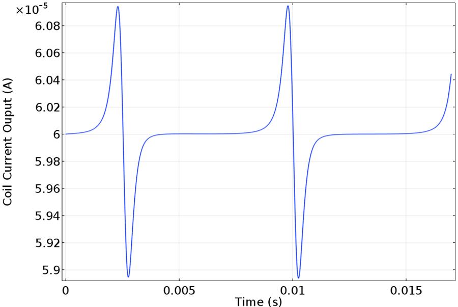

I have now used rotating machinery, Everything looks fine but my coil output current for simulatio is different than the required output as in attached image below.
