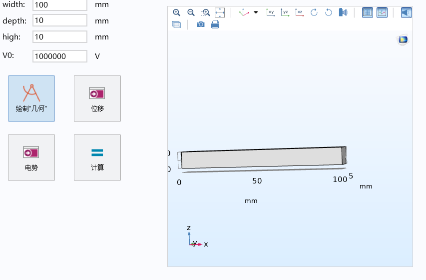

Dear I want to make some different results displayed in one graohic in Application Builder,just like the enclosure shows,yesterday i got it,but i don't know why?or! it's just comsol's bug?

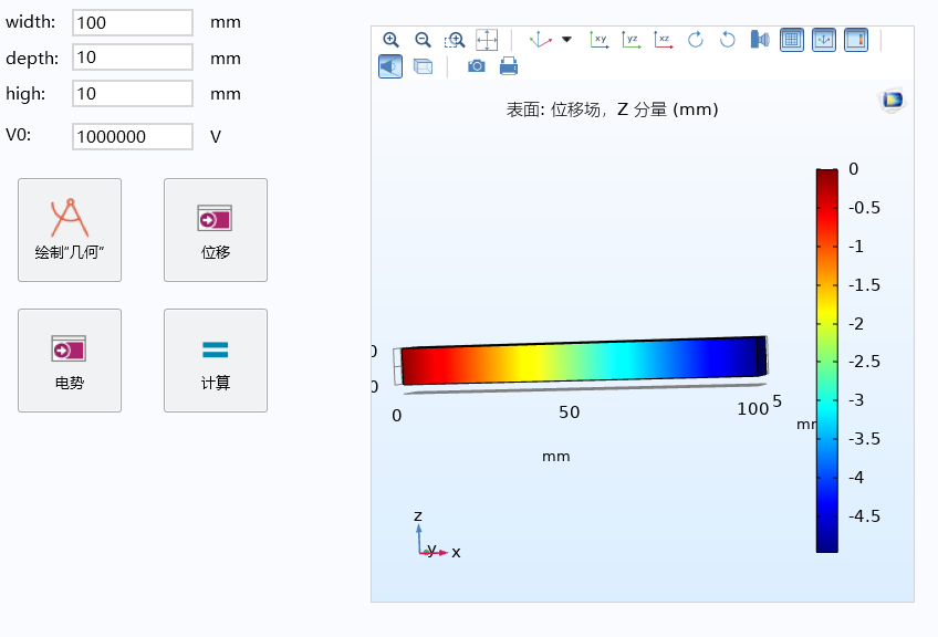

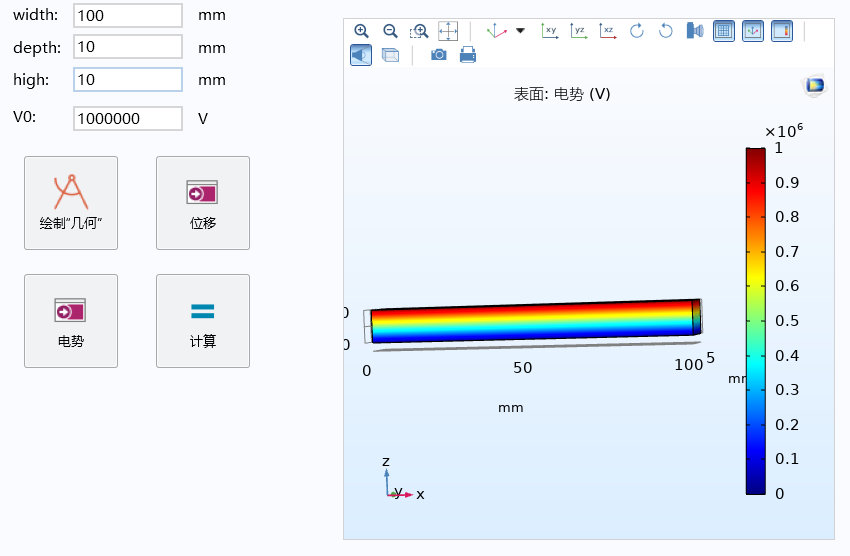

You can use the following code in a local method for the button:
useGraphics(model.result("pg2"), "frmRes/gfxLine");
instead of pg2 use the appropriate plot name for the desired plot in your application.
The frmRes/gfxLine bit tells the application to use the graphics item called gfxLine on the form named frmRes.
It looks like your graphics are on the same form as the plot buttons, so you shouldn't need the frmRes/ bit.
Each button can use similar code, pointing towards the same graphics object.
