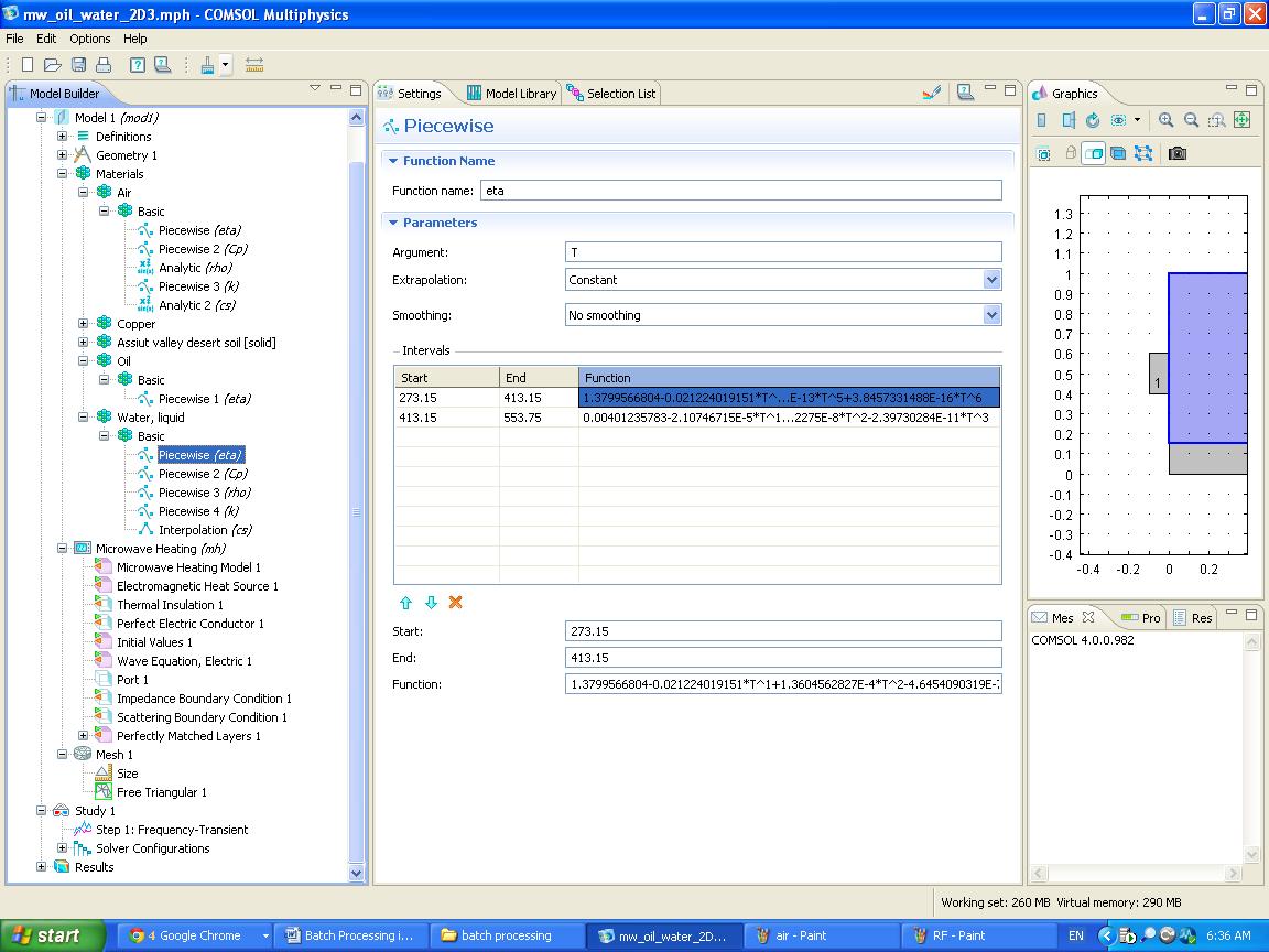

Posted: 1 decade ago 26 ott 2011, 10:31 GMT-4
Instead of providing linear regression equation in piece-wise function, you can use interpolation as it was done for speed of sound properties of water.
For taking into account of the convention, you need to use solve Navier-Stokes equations. I would recommend you to first set the RF physics right as convection will not change your microwave power distributions in the domain. alter on you can add up more physics.
Sohan

Posted: 1 decade ago 26 ott 2011, 12:38 GMT-4
Yes, it should work.
In developing multi-physics model, first set and solve the most important physics. In your case microwave interaction with oil bearing materials. First set RF wave and solve the EM field using frequency domain solver for your domains. When you obtain the dissipated power density pattern as per your experiences/ intuition, next step to set other physcis such as conduction and convection to take into account of conduction, and convection. Here you will need temperature dependent material properties.
Hope it helps,
Sohan
Yes, it should work. In developing multi-physics model, first set and solve the most important physics. In your case microwave interaction with oil bearing materials. First set RF wave and solve the EM field using frequency domain solver for your domains. When you obtain the dissipated power density pattern as per your experiences/ intuition, next step to set other physcis such as conduction and convection to take into account of conduction, and convection. Here you will need temperature dependent material properties. Hope it helps, Sohan

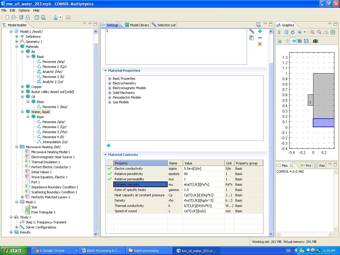

Posted: 1 decade ago 26 ott 2011, 13:58 GMT-4
Thanks Sohan,
After getting the heat dissipation with electromagnetic model, how can I change the properties of material?
As far as I think, the file will be the same and material properties will also remain same. I can change the study but how can I change the properties of material for second study?
In addition, how can I use this heat dissipation (obtained in case of electromagnetic heating) as initial stage for the heat conduction and convection model of second study?
This is the main problem: how to change the properties of material for second study while keeping the results of first study as initial conditions for second study?
I will really appreciate your response.
Many Thanks for your time.
Thanks Sohan, After getting the heat dissipation with electromagnetic model, how can I change the properties of material? As far as I think, the file will be the same and material properties will also remain same. I can change the study but how can I change the properties of material for second study? In addition, how can I use this heat dissipation (obtained in case of electromagnetic heating) as initial stage for the heat conduction and convection model of second study? This is the main problem: how to change the properties of material for second study while keeping the results of first study as initial conditions for second study? I will really appreciate your response. Many Thanks for your time.

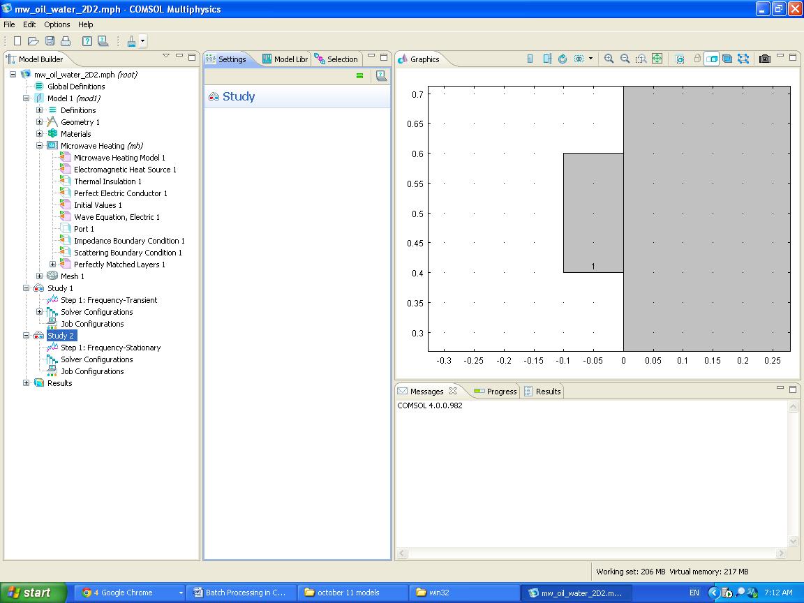

Posted: 1 decade ago 27 ott 2011, 16:35 GMT-4
You can change the material properties between studies. What COMSOL will take from the EM study is the heat generation. If your thermal conductivity changes in the second study, there is no problem.
If the dielectric properties of the oil however vary with temperature then you cannot solve for the EM field just once. You can leave out that level of complexity until you have worked out the other issues. Build up the model complexity gradually as Sohan described.

Posted: 1 decade ago 30 ott 2011, 23:17 GMT-4
Thanks a lot brother for your answer!
I tried to setup an other study but I have the properties of the materials as the same as you can see in the attached image. I want to run the first study with some settings of the material and then use the result of first study as base point for the second study.
If I proceed with simulation of first study and then change the settings of material properties manually and carryout the second study, is it the same what I want? I mean is COMSOL using the results of my first study as starting point or initial conditions for the second study, if not then how can I do that?
For the dielectric constant change with temperature, if I define my dielectric constant as interpolation function by inserting a table (different dielectric strength for different temperature) in the input of dielectric properties of oil, and simulate isn't it being considered as dynamic dielectric constant by COMSOL? Will the results of my simulation will incorporate the change in dielectric strength?
Thanks a lot once again for your time and support, JazakAllah!
Thanks a lot brother for your answer! I tried to setup an other study but I have the properties of the materials as the same as you can see in the attached image. I want to run the first study with some settings of the material and then use the result of first study as base point for the second study. If I proceed with simulation of first study and then change the settings of material properties manually and carryout the second study, is it the same what I want? I mean is COMSOL using the results of my first study as starting point or initial conditions for the second study, if not then how can I do that? For the dielectric constant change with temperature, if I define my dielectric constant as interpolation function by inserting a table (different dielectric strength for different temperature) in the input of dielectric properties of oil, and simulate isn't it being considered as dynamic dielectric constant by COMSOL? Will the results of my simulation will incorporate the change in dielectric strength? Thanks a lot once again for your time and support, JazakAllah!
Posted: 1 decade ago 31 ott 2011, 10:31 GMT-4
There is no need to simulate frequency-stationary study. Instead of it, I recommend you to add RF module and perform study with frequency domain solver. This will take material properties at initial temperature. Once you get satisfactory result showing power density, solve the coupled MW heat transfer using transient solver.

Thank you Ivar for your response!
I made all the changes necessary to change the color of orange expressions according to your instructions and the warnings have been removed. I did this because I was thinking that these warnings might be the cause for this error of stiffness matrix. I run the simulation again but still the same error persists. As it is mentioning mod1.E10, mod1.E20,mod1.E21 and Mod1.Ez, I think it is an error for the E-field, is it so? If yes, how can I remove it becasue there is no complexity involved in definition of E-field it is just as simple as Ex=0, Ey=0 and Ez=cos(pi*y/0.062[m])[V/m].
Is it possible that I am getting this error because of the definition of E-field in z component while I am using just a 2D model?
Undefined value found.

That could be, in 2D normally the "z" is constant, but in electromagnetics, you have the vector product that adds in Z components, even in 2D (x,y) now you shoudl check how your physics is set, what are you solving for, full 3D or in plane out of plane. I do not have acess to my COMSOL worlstation just now so I'm not 100% sure about the naing, and this depends on the physics chosen, take a look, and go over the doc once again

Posted: 1 decade ago 26 nov 2011, 23:41 GMT-5
Rehman,
The equation is valid for 3-d model. Instead of using symmetry of oven, use full 2-d model. For your 2-d model just create a rectangular port and add a wave guide piece with width of full wave guide. Assign port on one edge of the piece SE TE10 mode on one edge. I have attached a 2-d MW model simple model ( created in 4.2 a version) herewith for your reference .

Assalam o alaykum brother,
I am also trying to convert water into steam at a specific temperature (say 100 degree Celsius). I could not find any latent heat of vaporization in COMSOL and was wondering how can I define it.I have just a block of water and I am heating it with microwaves. It should absorb the heat and water should be converted to steam.
I also tried to change the specific heat capacity of water as suggested by you to Timo last time but on checking its specific heat capacity I found it defined as piece wise format:
Start 273.15 , End: 553.75 and Function: 12010.1471-80.4072879*T^1+0.309866854*T^2-5.38186884E-4*T^3+3.62536437E-7*T^4
How can I change this expression for it to include specific heat capacity very high near the boiling point of water?
Can you please suggest some thing?
Thanks.
Assalam o alaykum brother, I am also trying to convert water into steam at a specific temperature (say 100 degree Celsius). I could not find any latent heat of vaporization in COMSOL and was wondering how can I define it.I have just a block of water and I am heating it with microwaves. It should absorb the heat and water should be converted to steam. I also tried to change the specific heat capacity of water as suggested by you to Timo last time but on checking its specific heat capacity I found it defined as piece wise format: Start 273.15 , End: 553.75 and Function: 12010.1471-80.4072879*T^1+0.309866854*T^2-5.38186884E-4*T^3+3.62536437E-7*T^4 How can I change this expression for it to include specific heat capacity very high near the boiling point of water? Can you please suggest some thing? Thanks.
Posted: 1 decade ago 27 dic 2011, 15:10 GMT-5
Hei
What I remember from my training (but I havent tried it out yet) is that one can replace the linear Cp curve by an "S" with a steep increase around the boiling temperature, but o stay continuous (no sharp angles on the interpolation curve) and typically spread the extra latent heat capacity over 0.5-2degC width.
With a varning such rapid changes in slope often are overlooked y the sovler stepping, in automatic mode, so careful time stepping is often required

Posted: 1 decade ago 27 dic 2011, 21:12 GMT-5
There are several ways to do that. One way is to add to Cp a built-in “Rectangle” COMSOL function that acts around 100 Celsius (say from 98 to 102). The function value should be zero below 98 and above 102, and equal to the latent heat divided by 4 between 98 and 102. Make sure as Ivar mentioned to select a smooth function and make sure also that the time stepping is small enough to not skip over that narrow temperature range.
Nagi Elabbasi
Veryst Engineering
There are several ways to do that. One way is to add to Cp a built-in “Rectangle” COMSOL function that acts around 100 Celsius (say from 98 to 102). The function value should be zero below 98 and above 102, and equal to the latent heat divided by 4 between 98 and 102. Make sure as Ivar mentioned to select a smooth function and make sure also that the time stepping is small enough to not skip over that narrow temperature range. Nagi Elabbasi Veryst Engineering

Posted: 1 decade ago 28 dic 2011, 03:35 GMT-5
Hi there are two ways, once the function has been defined:
Either in the physics node ou define a UserDefined Cp with the expression referring to the different functions or parameters or typing you need, ...
or directly in the related material node in the Cp variable field
Hi Hi there are two ways, once the function has been defined: Either in the physics node ou define a UserDefined Cp with the expression referring to the different functions or parameters or typing you need, ... or directly in the related material node in the Cp variable field -- Good luck Ivar

Still I am not getting it how to include the function value inside my Cp calculation? As you would have seen in the file I sent you last time, the built in Cp is being defined as a function of T as
with temperature ranging from 273 to 575 Kelvin.
Do you mean that I should define Cp as this function ranging from 273 to 371 Kelvin and 375 to 575 Kelvin while rectangular function will be defined as Cp/4 in between 371 and 375 Kelvin?
If so, it can also be defined as an interpolation function without caring for definition of rectangular function, am I right?
Please clarify...

Posted: 1 decade ago 28 dic 2011, 12:16 GMT-5
if you want to refer to a function, only reated to a material property, you can create/add a new material, then right click the "Basic" node and add local fuctions therein, and refer to them in your material property expressions. Check how it's don ein the "complex" materials inthe built-in material library, (i.e. "air"),
with the interpolation function you can use higher order interpolation polynomial to make it rather "smooth", following the values as Nagi explained
Hi if you want to refer to a function, only reated to a material property, you can create/add a new material, then right click the "Basic" node and add local fuctions therein, and refer to them in your material property expressions. Check how it's don ein the "complex" materials inthe built-in material library, (i.e. "air"), with the interpolation function you can use higher order interpolation polynomial to make it rather "smooth", following the values as Nagi explained -- Good luck Ivar
