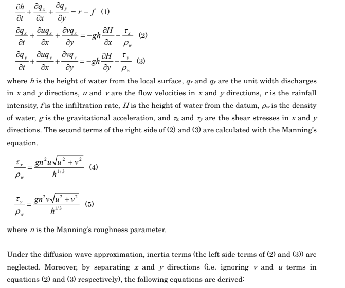

Hello. I'm having a difficulty in modeling 2D shallow water in COMSOL to model a river flow. All I could not understand is how we could identify boundary conditions and how to implement them in COMSOL. Any idea would be highly appreciated. I here with have posted the model equation and the COMSOL file.
