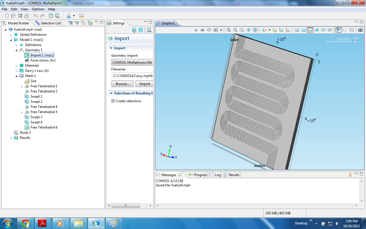

Posted: 1 decade ago 18 ott 2012, 09:42 GMT-4
Hi Ivar..
I have attached my gemotry file.I could not solve for Darcy flow through the domains-hydrogen channel,as i specified in the selections list.I tried also,with laminar flow in the same domain.I couldnt solve for the velocity profile. I get error in multiphysics compilation or error in evaluating variable spf.U,if I use laminar.My problem - hydrogen channel has laminar flow and the fluid diffuses into the underlying next layer and reaches its next for reaction.I'm very much new to COMSOL but given a complex project.I'm struck up with the initial flow solving itself,and couldn't proceed next.Please help me to resolve the issue.I have attached the assembly geometry since the mph file faced uploading error and aslo have notifiedthe channel in the png file attached.Please bear with me and help for the problem
Hi Ivar.. I have attached my gemotry file.I could not solve for Darcy flow through the domains-hydrogen channel,as i specified in the selections list.I tried also,with laminar flow in the same domain.I couldnt solve for the velocity profile. I get error in multiphysics compilation or error in evaluating variable spf.U,if I use laminar.My problem - hydrogen channel has laminar flow and the fluid diffuses into the underlying next layer and reaches its next for reaction.I'm very much new to COMSOL but given a complex project.I'm struck up with the initial flow solving itself,and couldn't proceed next.Please help me to resolve the issue.I have attached the assembly geometry since the mph file faced uploading error and aslo have notifiedthe channel in the png file attached.Please bear with me and help for the problem
Posted: 1 decade ago 18 ott 2012, 11:04 GMT-4
setting up such a model, even if it seems simple, and learning COMSOL the same time is far from trivial. I can only suggest to start simple, i.e. take a thin straight tube of correct section and representative length. Then get the laminar flow running, add more complication, and i.e. diffusion through a wall, turbulence, ...
But only one at the time.
Then check the parameters, can the model be simplified, does a long tube need to be simulated in detail through its section or can it be made 1D ? else you need a cluster to solve it, and more time to learn and validate that approach
And others out there might have further suggestions ;)
