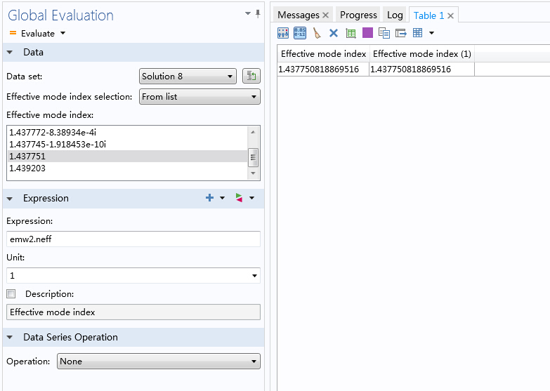

Thanks for your immediate reply. The thing is I have setup the PML layer and get the imaginary part for most of the effective indexes. But the problem is, for the optimal effective index with minimum value of imaginary part, I can not see the exact value of imaginary part. I guess it may be a matter of the value is too small, e.g. <E-12i, so it is not displayed. The attach file is a screenshot of the effective index I got.
In the Comsol3.5 version, we can get the exact value via generate the report, but I don't know how to deal with it in COMSOL4.4. Any experience with this?
Posted: 9 years ago 1 gen 2016, 08:56 GMT-5
This is because the Imag(Neff) is too small. Loss is negligible.
You can see the full precision at comsol UI. On the bottom right (the table..), you generate your Neff and click the full precision.
Or if you have comsol matlab, you can see the full precision also.
This is because the Imag(Neff) is too small. Loss is negligible. You can see the full precision at comsol UI. On the bottom right (the table..), you generate your Neff and click the full precision. Or if you have comsol matlab, you can see the full precision also.
Posted: 9 years ago 1 gen 2016, 09:25 GMT-5
I have tried evaluate neff in the table with full precious, but it just display the full precious of the real part, for the imaginary part, it is still not viable. See the attache file for the detail.
