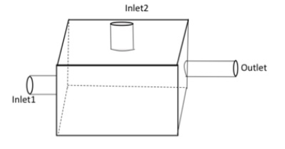

Well, you should be able to specify time-dependent functions as user-defined boundary conditions in your time-dependent problem. For example, define the functions of time you need under Component --> definitions --> functions and then enter those functions where you would specify your inlet BCs. Have you already tried that?

thank you for your help, I'll try it.
