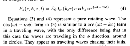

To clarify: by "rotating-wave electromagnetic," do you mean a circularly-polarized electromagnetic wave?
Posted:
4 years ago
8 mag 2020, 00:21 GMT-4
yes circularly-polarized electromagnetic wave as is show in the figure.
Could I simulate a cylindrical cavity in 3d with two ports at the bottom of the cavity with this type of wave (figure)?
Thanks for the help.
