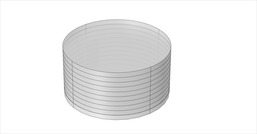

Hello everyone,
I was wondering if you can help me with this. I'm trying to model a piezoelectric stack containing a number of disks as an actuator in comsol. For lower numbers of disks I can manually select the boundaries for which I want to apply the boundary conditions. However, for larger numbers of disks (e.g. 700 disks), this is not viable. For my case, I'm intending to apply an Electrical Potential condition on the upper surfaces of the disks, and a Ground condition on the lower surfaces of the disks. I'd be glad to hear your suggestions.
Thanks.
1 Reply Last Post 12 mag 2020, 01:28 GMT-4
Andres Felipe Jaramillo Alvarado
Posted: 5 years ago 12 mag 2020, 01:28 GMT-4
You can try to use the "Array" component in the geometry definition for your simulation. This often solve that problem.
First doy the array and then only after that, select the domain/bondary conditions for each physics interface, after that, Comsol usually remap the identifier of edges and domains after that process.
You can try to use the "Array" component in the geometry definition for your simulation. This often solve that problem. First doy the array and then only after that, select the domain/bondary conditions for each physics interface, after that, Comsol usually remap the identifier of edges and domains after that process.
