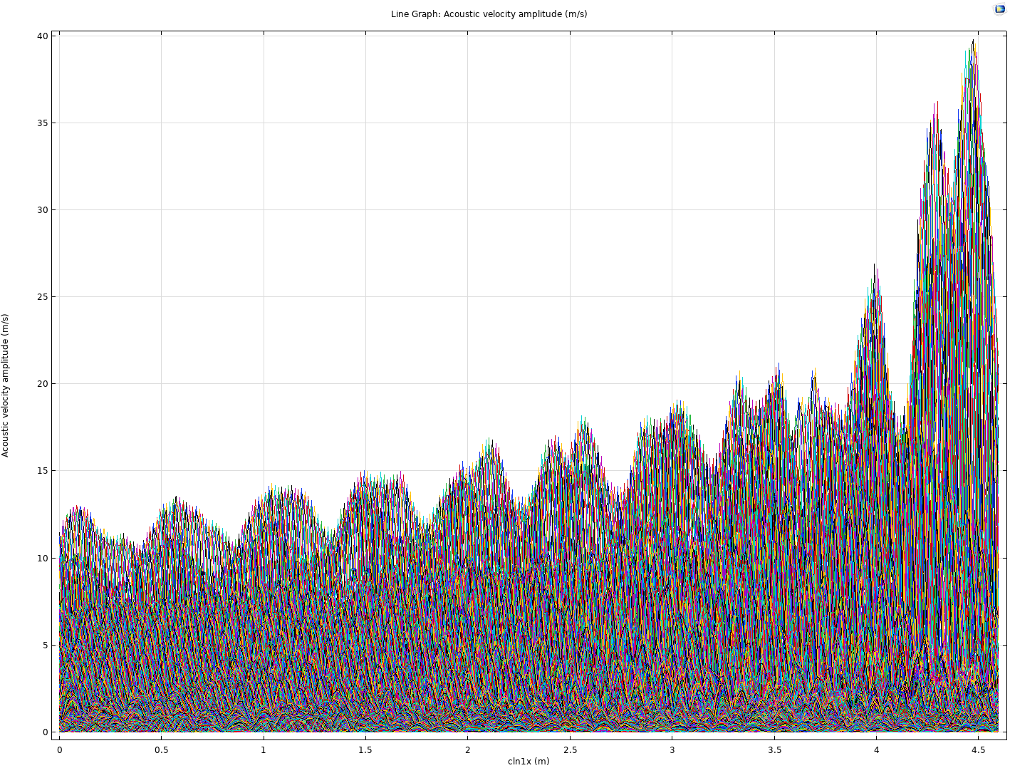

Could you please help me with plotting the results of my pressure acoustics, time explicit simulation (pate).
I need to plot the results along the created line. I draw a cut-line (in the results section) and displayed pate.pt in the Line Graph. I tryed different parameters, but I was not able to find a suitable plot type in the comsol. My results are shown in the figure below.

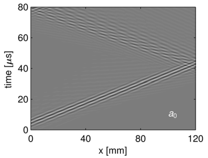

But I need to display them differently as shown on the second figure-time-spatial distribution of estimated parameter (pressure for example). Could you please advise how it can be done?
