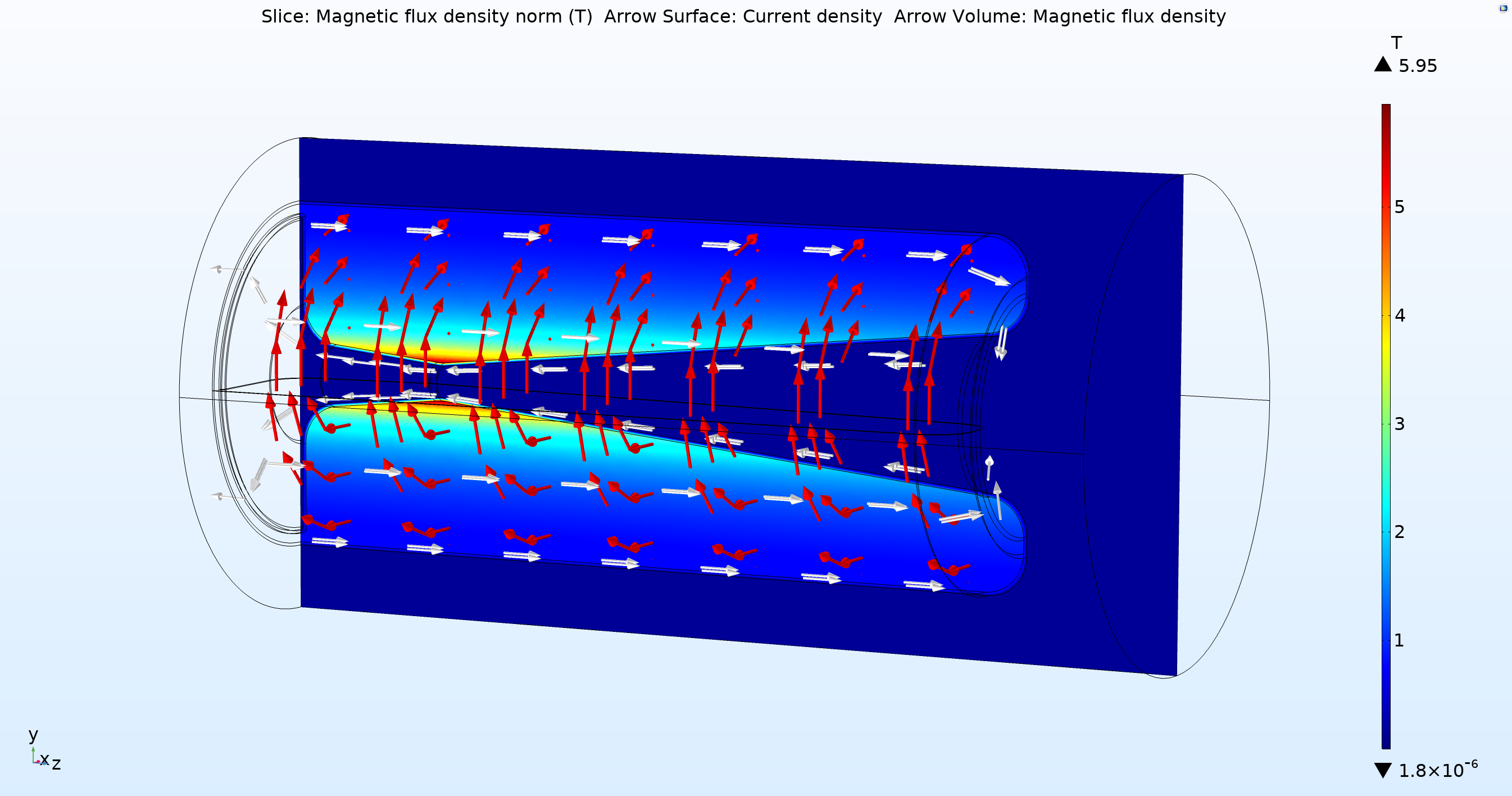

The idea of the coaxial port seems the right way in this case, however: 1- Option "Coaxial" of the "Type of lumped port:" is not available for any of the AC/DC module physics nodes!! I am using "Magnetic field (mf)". 2- While it is different physics, I tried to guid myself abit with this example, to understand how the lumped port works. So, I defined the input and output ports (with terminal type = current), please see the attachment. However, this gave me non-understandable results. 3- I also tried to assign the terminal between the two conductors as you suggested, but still the solution is not correct.
Just for guidness, I also attach the corresponding/correct/expected result from the 3D model!
Any advice!
Regards, Tamer
Hi Edgar, The idea of the coaxial port seems the right way in this case, however: 1- Option "Coaxial" of the "Type of lumped port:" is not available for any of the AC/DC module physics nodes!! I am using "Magnetic field (mf)". 2- While it is different physics, I tried to guid myself abit with this [example](https://www.comsol.com/model/time-to-frequency-fast-fourier-transform-of-a-coaxial-low-pass-filter-43851), to understand how the lumped port works. So, I defined the input and output ports (with terminal type = current), please see the attachment. However, this gave me non-understandable results. 3- I also tried to assign the terminal between the two conductors as you suggested, but still the solution is not correct. Just for guidness, I also attach the corresponding/correct/expected result from the 3D model! Any advice! Regards, Tamer
