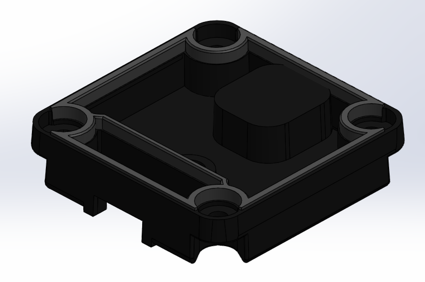

I have been asked to develop an FEA model of a component we are moulding out of glass filled nylon material. The component is shown in the attachment, together with a seal which is moulded into a groove on the plastic component.
The seal itself is made from a Silicone rubber.
I have run a stationary model to determine the load on the plastic as the seal is compressed. It is my plan to add a time dependant study to determine the expected creep behaviour of the plastic over time (no temperature dependance initially, just a room temperature stress induced creep).
