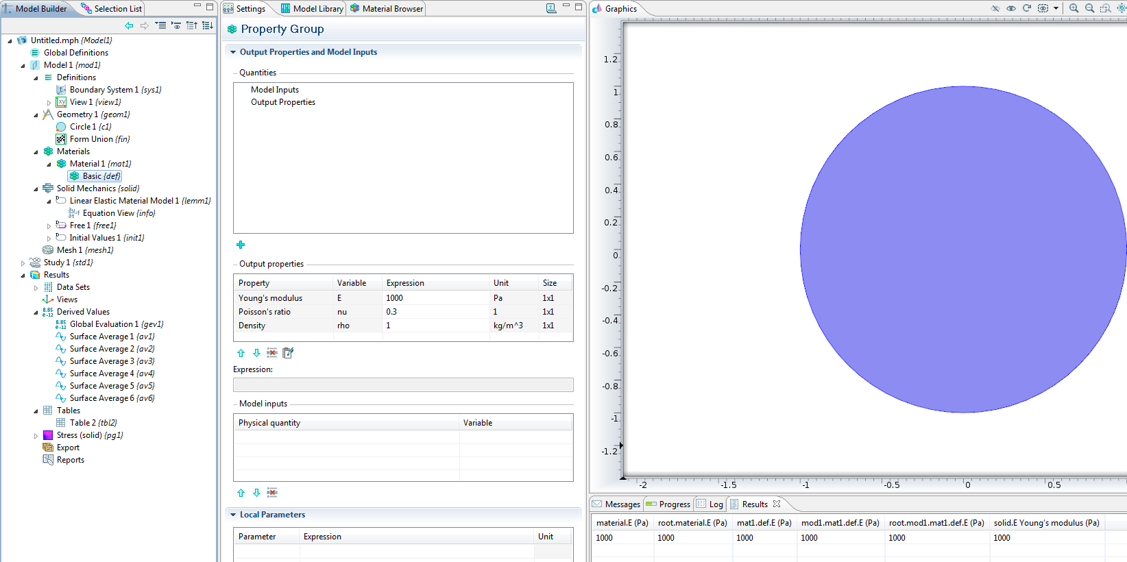

again the naming convention, it all depends on the physics ;)
For standard material properties such as E the young modulus in Solid (see image) it woks with the different names, but take note: these are not variables but fields: it is E(x,y,z,r,t) (for the Young modulus) or whatever applicable.
For the diffusion coefficient D, if you look under the equations, in CHDS physics, the Diffusion coefficient is first defined in the physics and NOT in the materials, then it is distributed to its tensor coefficient chds.Dxx, .Dyy, .Dzz, .Dxy ... (this is also the case for k the HT heat conduction and many other variables).
Therefore I always take a look at the equation view to find out how COMSOL remaps the values I give and their names. For that using the "tag" view, see the image is easier than the name and identifier, to understand the full path "root.mod1.mat1.def.E" or in shortcut generic since 4.2a "material.E" but not material.D and neither NOT material.Dxx, as its NOT defined in the material section but the physics. The latter point could be brought to supports attention, I belive they could consider that change, try to send them a mail ;)
