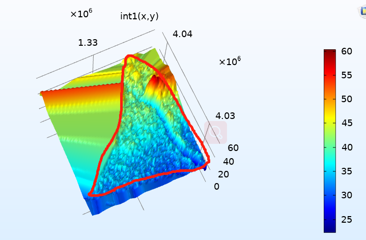

I want to import the irregular geometry model to COMSOL and I have imported the text file, the function diagram is rectangular but the text file I imported just have some coordinates of the rectangular. When I created a parametric surface, it also was a rectangle, I just want to display the coordinate image that I typed in( circled in red ), how do I crop the resulting parametric surface?

You can create a prism that intersects the parametric surface to trim it.
To create the prism, you can draw a parametric curve in a workplane, and then extrude that shape into a 3D prism.
