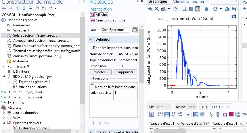

Hello, A a new COMSOL user, I am currently trying to run a simulation which has to define functions from solar spectra data.
I managed to create a new function called "solar_spectrum" by interpolation of a data file (see attached file) Now, I would like to use this function in another function called "modified_spectrum".

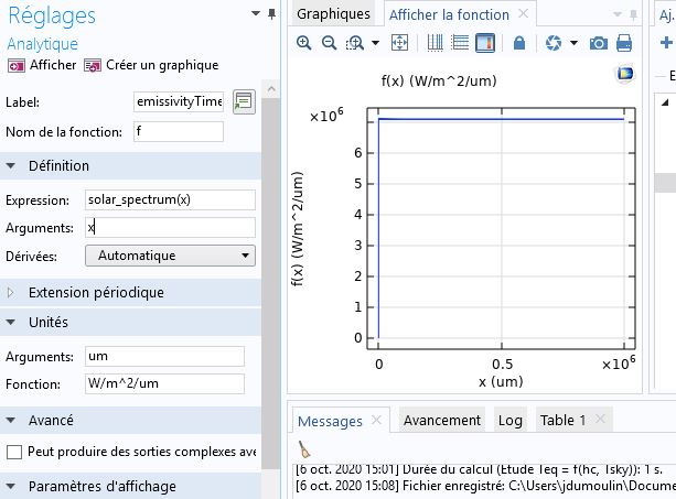

But it doesn't seem to work. I can't even display the first function when calling "solar_spectrum(x)" in the this new function...

Hi Jeremy,
it works if you omit the units everywhere. I remember having teared my hair about such issues before. I prefer to manually scale everything to stay with basic SI units.
Cheers Edgar

Posted: 4 years ago 6 ott 2020, 10:33 GMT-4
Hello Edgars,
Thank you so much! It works fine now.
Jeremy
