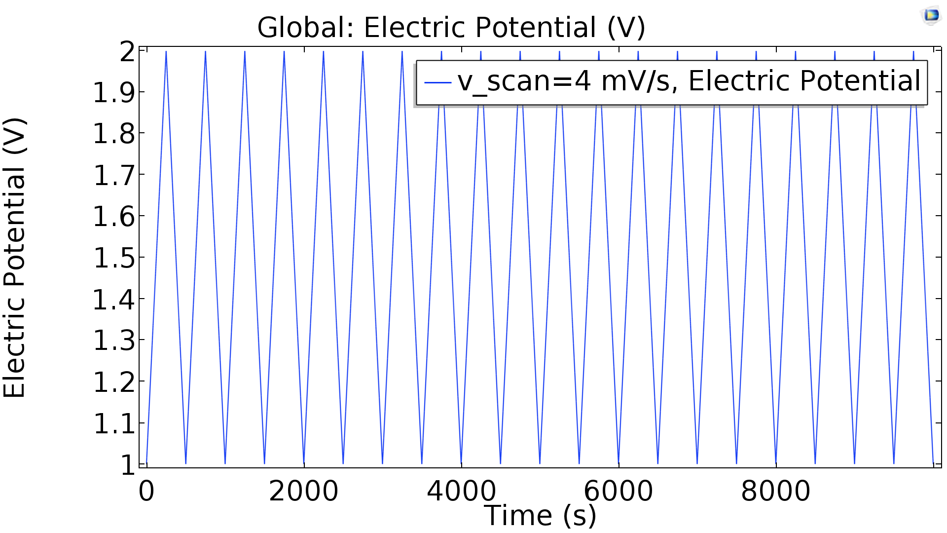

I'm trying to run cyclic voltammetry study with 100successive cycles. However, at scan rate = 4mV/s, at scanning potential E_vertex1 =1V & E_vertex2 = 2V (1 cycle at 4mV/s scan rate = 500s). The maximum cycles that the study completes is only 20 cycles (10,000s).
When I try increasing the scan rate to 10mV/s with a goal of performing 100 successive voltammetry cycles, the comsol study ends at 50 cycles (still at 10000s).
Is there a way I can increase the allowable time to perform cyclic voltammetry greater than 10000s?

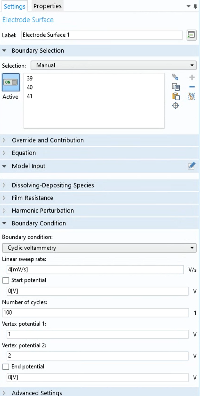

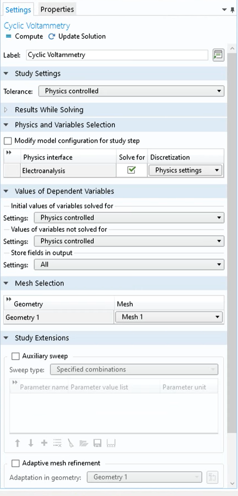

Yeah I agree time dependent studies has default settings. But in my case, I did not have a chance to set this time given that I'm running cyclic voltammetry studies( see attached screenshots for the some of the configurations).
In this kind of simulation, you set the linear sweep rate, vertex potentials 1&2 and the number of cycles you will run your simulation.
In a cyclic voltammetry, 1 cycle represents 1 forward and reverse sweep (i.e Vertex 1 -> Vertex 2 -> Vertex 1). So in effect, the time to complete 1 cycle at 4mV/s rate is equivalent to
note: It is multiplied by 2 to cover the reverse scan.
At , the total time must be 50000s, however as I said before, I cannot run simulation greater than 10000s, making the solver fails to reach the target 100cycles at 4mV/s(only 20cycles at 10000s). I don't know if this is set as default in comsol but I'm not using Time dependent on my studysteps so I guess the problem is elsewhere.

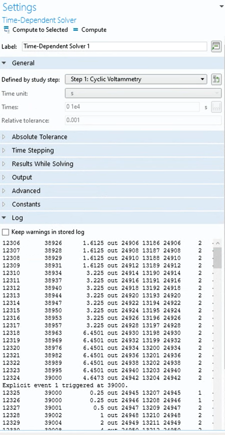

Thank you for your help, I solve the issue following your suggestion. It turns out by default, the maximum timestep in the time-dependent solver for Cyclic voltammetry is set to 0 1e4(see attached screenshot). I was able to change it by manually defining the solver.
